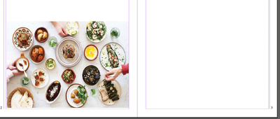

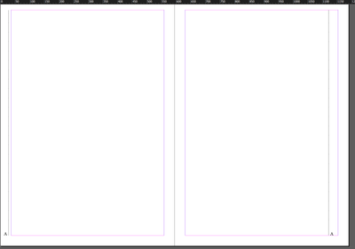

I'm running into another problem. Here is what the master page looks like in my case: (note how the right page line and page number are a bit shifted to the left)
How this looks on pages from 2 to 13 (from 15 total):
So far so good, but only on the last pages it looks like this:
Now when I edit the master page so it's not shifted to the right, page 15 will be displayed correctly but all other ones will not show the line and page number.
All pages are A4 size, so I'm a bit confused. Could you please help me with this?
Thank you!
Dec 17, 2020 Dec 17, 2020
Hi @Adnan7:
It looks like overrides to me:
  1. Start by reassigning the master page to those erroneous body pages so that all pages are consistent.
  2. Remove any duplicate objects from the body pages that may appear.
  3. Then remove just the page numbers with the shortcut I gave you earlier.
Effective use of master pages is essential for long document layout. When you have some downtime, make a plan to figure how they work. You will find free videos, tutorials and of course the Adobe Helpx page—all of which will get you up to speed if you don't want to invest in training (which, as a career trainer, I always encourage!). 😊
