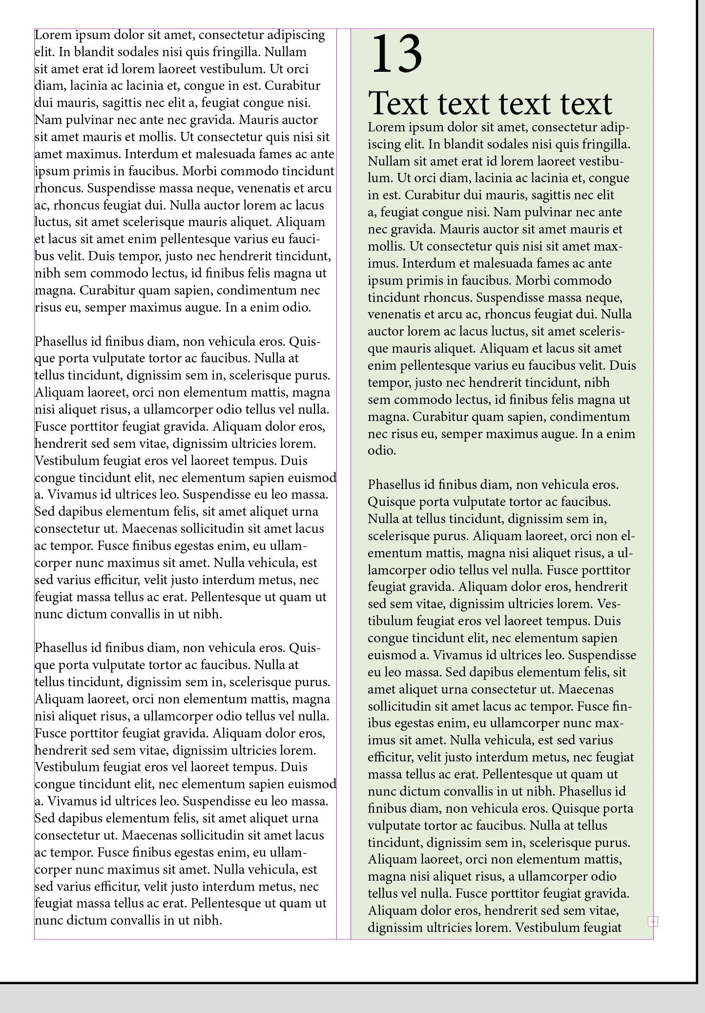

I have a two-column layout with running text:
1st column: Text without background
2nd column: Paragraph shading
How can I control the spacing between the top of the green box and the top of the text while keeping everything inside the column? My main issue is achieving exact spacing above "13" and at the bottom of the green box. I used left and right indents to adjust the text spacing but cannot use "space before" (nothing happens).
I know that I can use the offset in "Paragraph Shading," but that would push the shading outside my column. Is there a way to solve this?

Shading does not lend itself to inside spacing, only to "expanding" past the text using the offset. As you've discovered, you have to use other features to space text in, then expand the shading (and borders) offset to fill space to the margins.
The only reliable way to get space at the top of a page/frame/column, though, is to use a Rule Above on the first paragraph. The basics are:
  • Set a Rule Above for you '13' paragraph.
    • The rule can be 0 points, [None] color or both — whatever makes it i
Mar 10, 2025 Mar 10, 2025
    • The rule can be 0 points, [None] color or both — whatever makes it invisible on your layout.
    • Set the rule's offset to the space you want above.
    • Make sure to check Keep In Frame, as that's what forces InDesign to bring the rule down to the top margin instead of letting it float above.
  • (And yes, that's the canonical/correct/only way to do top spacing at page tops!)
Equivalent spacing at the bottom is another problem, and I can't think of a good, consistent. styles-driven method for that. I think the assumption is that you'll use a text frame for insets like this, which would make it all much easier to manage.

Hi James, thank you so much for your help! I think this will solve my problem, appreciate it alot!
