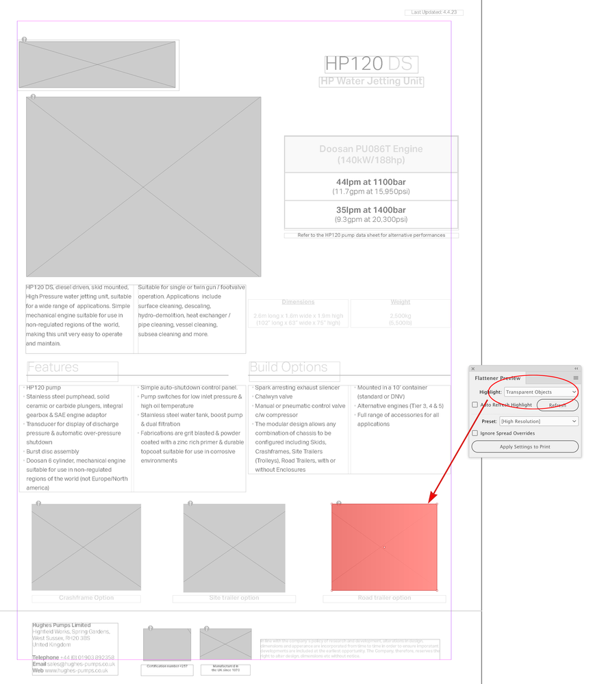

Also, you have a single object on the page with a Transparency Effect that isn’t actually doing anything—if you remove the Effect there will be no transparency on the page to flatten:

The Flattener Preview is showing the frame with the Gradient Feather applied as the only transparent object on the page:
The backgound PDF doesn’t appear to have any transparency—can you share it?
