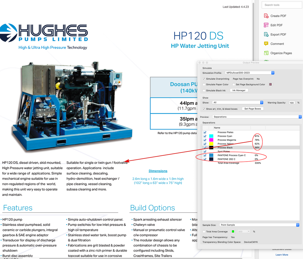

Also, the PDF you posted has 2 Spot Plates, which I doubt will ever be printed as extra plates on an offset press, so set the Spot swatches in your document to Process—double click the Spot swatch and set its Color Type to Process.
And the text in your PDF is 4-color which is probably contributing to the bolding. A default PDF/X-4 Export should fix that unless the text color has been set to RGB in the ID doc:

It would seem that these are PDFs exported and optimized for commercial printing.
The 4-color text would be a problem on an offset press. Also, the image and some of the blue text is DeviceRGB (no profile), which would mean the conversion to a CMYK print space could not be color managed. I think @Jeffrey_Smith’s question about the printing device matters—the PDF isn’t ideal for either offset or a composite printer.

When some lines of text look bolder than others, that is always indicative of a flattening issue.
Your page is almost 100% transparency objects, and that is affecting how your text is being handled. Your document is being flattened before it reaches your printer according to the setting in your Acrobat Print dialog, and because of that some, but NOT ALL of your text is being converted to outlines in the process. The outlined text will look bolder because it's no longer getting the benefits of the hinting built into fonts to improve their appearance on lower-res printers. Making it worse is that your text Black is not a pure 100K Black in this PDF and instead isn an RGB Black converting to a very rich black, as mentioned already by others in this thread. If you have built your document using 100K for text, then you need to change your PDF Export settings not to mess with that.
Attached is how the flattening is happening in your document. As you can see, the text that has been turned to outlines matches up to the lines of text that look bolder in your screen grab.
So, this may come down to a layering issue. Try create a layer for all your text objects that is ABOVE everything else, especially any transparency-affected objects.
