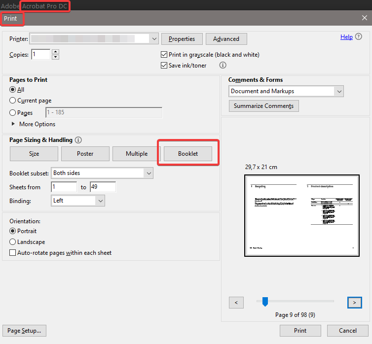

Yes, you should export the PDF as usual from InDesign, then use Acrobat Pro to print as booklet.
Participant ,
Oct 22, 2020 Oct 22, 2020
I'm using the Acrobat booklet feature, but somehow Acrobat doesn't want to send to my printer queue

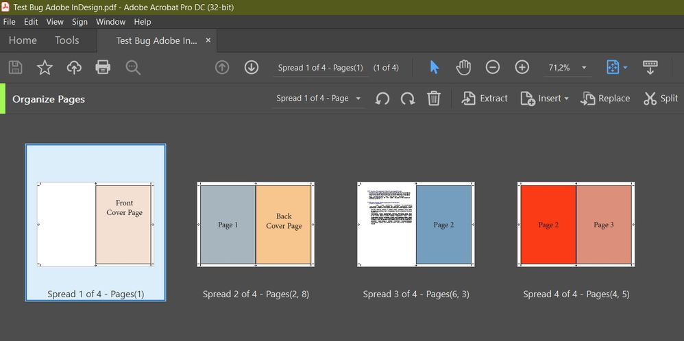

I have same problem also when create a brochure as the facing pages which one page is a blank page, then InDesign cannot sort the page perfectly after export a PDF through Print as a Booklet... please see my sample attached.
The reason I frequently use the Facing Page due to easy to sort a page base on number which for the facing page print as booklet should be have minimun 4 pages then Print as a Booklet to create a PDF with Print & Crop Mark to print in commercial printing facility.Bug Print as Booklet.jpgSample Desain a Brochure.jpg

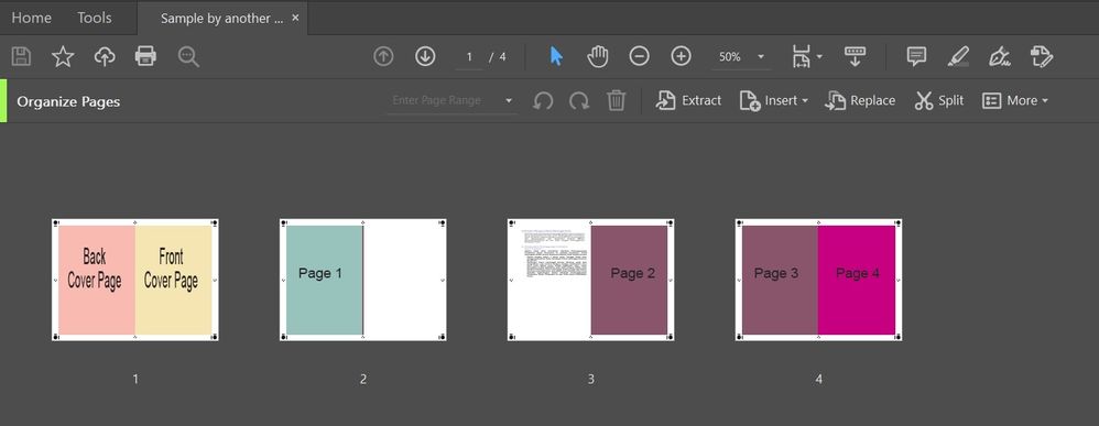

This Print a Booklet as PDF with correct sort page even with the same layout which page 6 & 7 is facing page and page 7 contain a blank page, no issue after print as a booklet (I use another app.).
I hope from Adobe InDesign Technical Support can assist as to solve this issue.

Sorry forgot to attach a screenshot the correct PDF layout.No Issue for the page sort as facing pages.jpg
