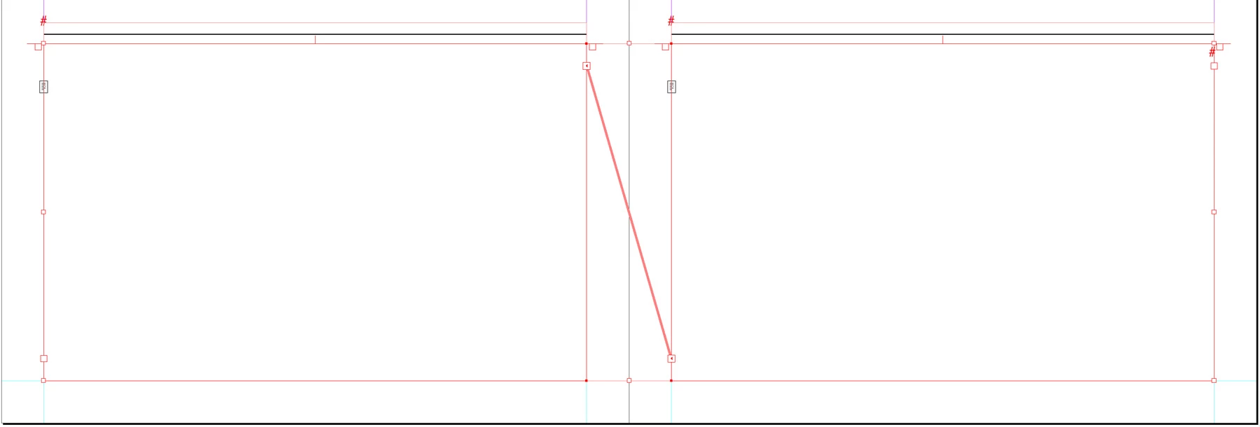

I created a text frame and made it's frame into "Type on Path". I then inserted a horizontal stroke with baseline shift so It will always be on the same distance from the top when I change the text frame's height. The text frame was also defined with Text Wrap (Jump to next column). I did it because there is no way to give a stroke to one side of a text box or any other graphic object (like you can do in a table cell).
The text frame was placed on a parent page, on both sides of the parent spread and was threaded (In my case from Right to Left) like this:

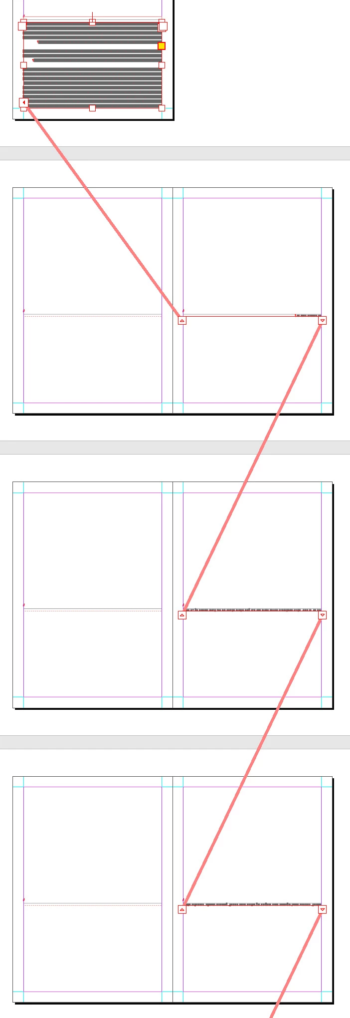

I then went to page 1 I loaded the text I had in another text frame on the pasteboard and shift+Clicked the frame on the first page to auto flow it into these frame I created in the Paren Spread. InDesign didn't recognize that they are threaded in 2 ways:
1. The text flew into the first frame but then it flew into the type on path area.
2. InDesign flew the text only to the Right side pages and ignored that the text frame was threaded.
When a text frame is set with "Type on Path" area,  InDesign prefers to flow the loaded text into that area and will ignore the threaded text frame.

I am still unable to replicate the flow of the text into the path of the frame.
I can paste the text into Page 1 and have an overflow box.
Then click the overflow box to load the cursor
Then add a bunch of pages
Zoom out so you can see all pages
Then ALT Click (windows) and click on each frame while holding Alt and all the frames fill with text.
But no matter what I do I can't get it to flow into the Path of the frame, odd that it doesn't happen for me.
