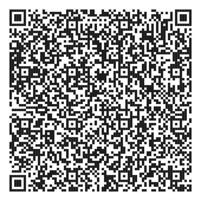

Explorer ,
Oct 30, 2023 Oct 30, 2023
Ich weiß nicht,
folgender Quellcode als "nur Text" QR-Code erzeugt, wird zwar von meinem Smartphone als Kontakt erkannt, ist dann aber Inhaltsleer:
BEGIN:VCARD
VERSION:3.0
N;CHARSET=UTF-8:Mustermann;Max;;;
FN;CHARSET=UTF-8: Max Mustermann
EMAIL;type=HOME:max.mustermann@web.de
TEL;type=HOME;VOICE:+49123 456789
ADR;CHARSET=UTF-8;HOME;type=pref:;;Musterstraße 8;Musterstadt;;12345;Deutschland
LABEL;HOME;PREF;ENCODING=QUOTED-PRINTABLE;CHARSET=UTF-8:Musterstraße 8=0D=0A=
12345 Musterstadt Deutschland
REV:2023-10-30T12:36:11+01:00
END:VCARD
Hier der erzeugte QR-Code:
I have no idea why or what's happening, but the QR code you provide does indeed come up null — no data at all. However, your data in a Plain Text export from InDesign generates a completely valid code, including the 'sharp S':
The only thing I can figure is that your text has a break in the address line (after 0A= in the LABEL line), and if I replicate that break in my entry, the code comes up similarly null.
All data lines in a QR code spec must be unbroken. Since it can be difficult to tell a line wrap from a line break, I suspect broken lines in cutting from Notepad and other sources will turn out to be the source of most of these problems.
