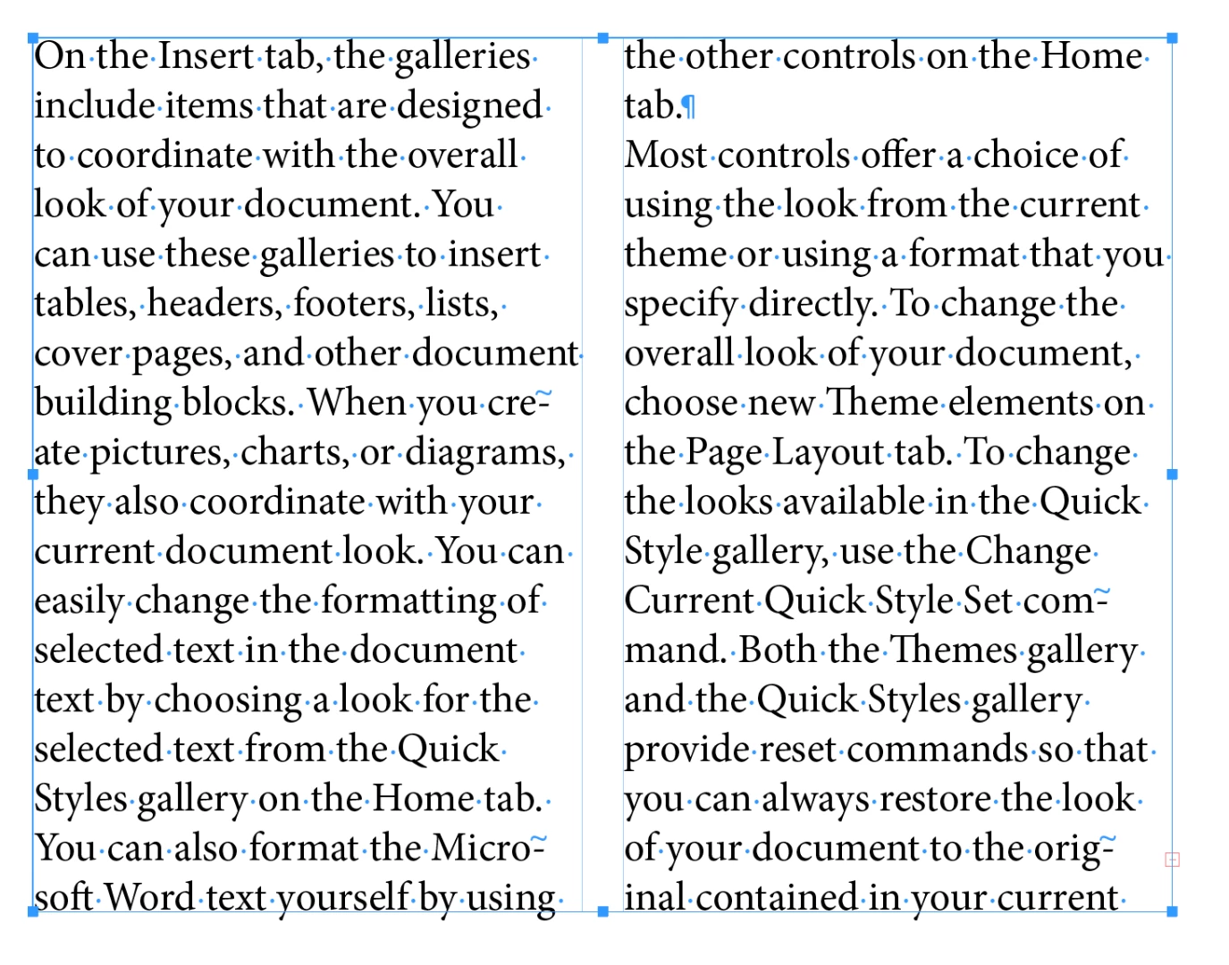

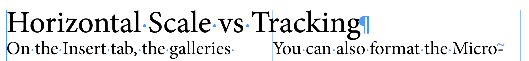

Sara: did you understand the answer to this question? It's in the thread, but I'm wondering if it was as clear to you (a newer user) as it was to the rest of us. Here's a visual recap—and this has nothing to do with the baseline grid, as per Jongware. It's off in my screen shots.

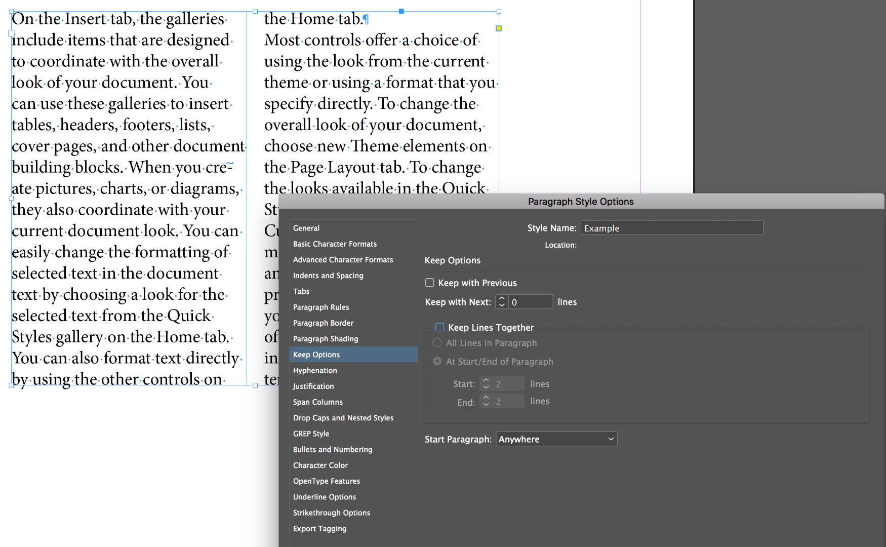

1.) there is room for one more line in column 1, but the text isn't using it. As Vinny said, when Keep Lines Together is activated, and at Start/End of Paragraph is set to 2 lines, this will happen. (Single lines of a paragraph that are separated from the others in the same paragraph are called Widows and Orphans, but InDesign doesn't use that terminology here, for whatever reason.)
2.) So, if you are OK with single lines (see "the Home tab." at the top of column 2?) you can turn this off. Or better yet, keep it on and copyfit—which means rewriting the text to fit the space.
3.) As per Bob's comment, add or delete a few words until the text flows back into the space. InDesign lets it because there are still two lines together at the top of the next column. I also mentioned tracking (adjusting the letter spacing) but only if it's too subtle to be observed. It's consider cheating by many. Copyfitting by adjusting the content is the correct way.
I'll point out that it's also not good practice to end a paragraph with a word all by itself like in my last screen shot ("tab."), but that's a topic for another day.

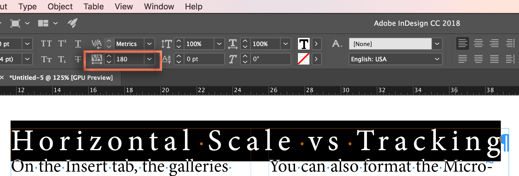

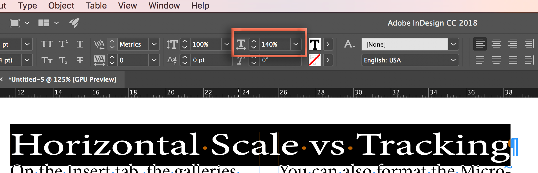

About one word on a line, I have been manually fixing those by using the Horizontal Scale. What is a better method?

I agree with Bob that it is not necessary, but, if vertical justification is important to you, try copyfitting: add a word or two to the sentence that ends in footnote 15. Or *ever so slightly* increase the tracking on that paragraph so that it wraps to an additional line. Either technique allows you to keep two lines together in the second column, while still allowing the first column to reach the bottom margin.

This is typical and normal behavior while using Keep options to keep the last 2 lines of a paragraph together in order to avoid widows.
