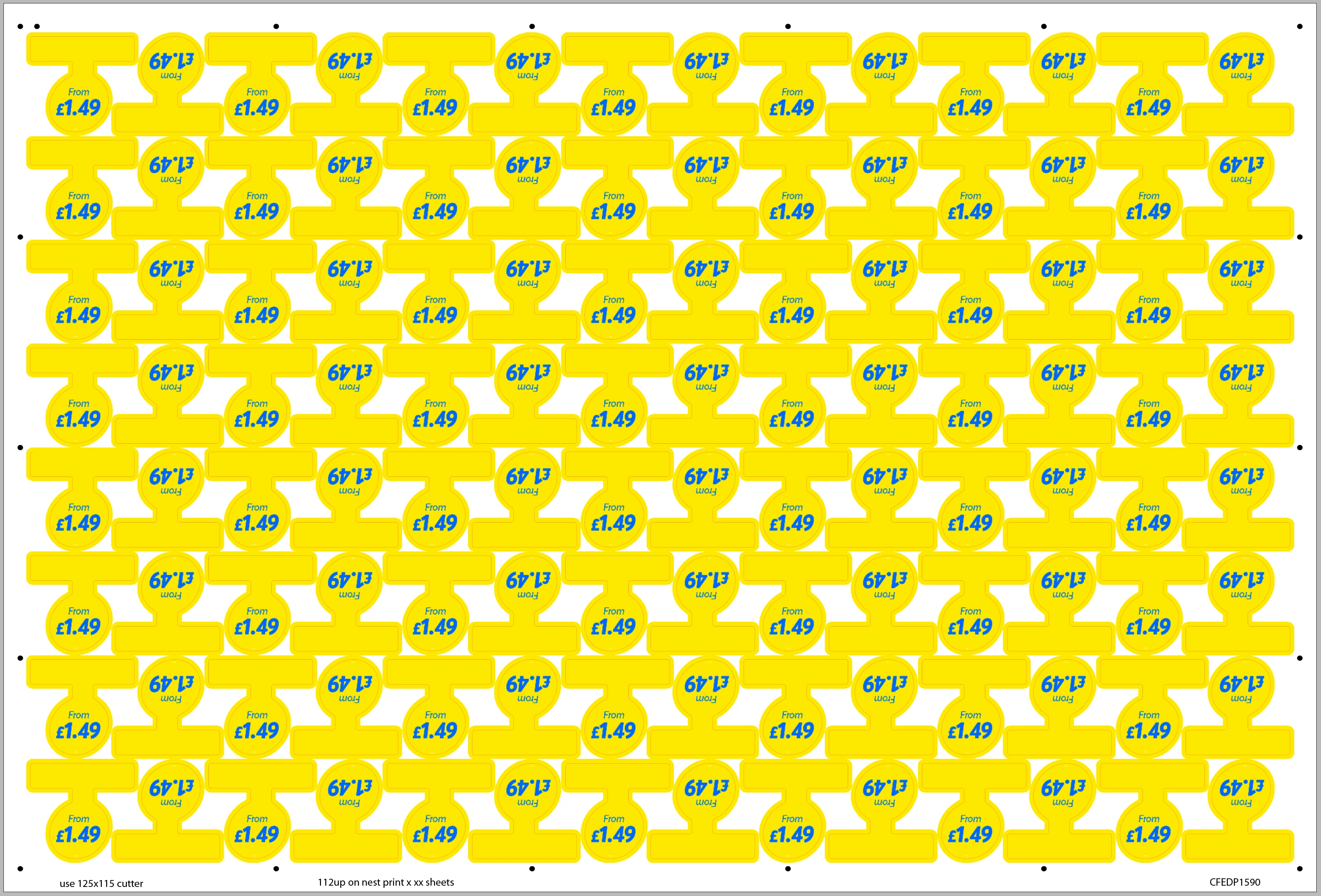

Is there a way I can relink a select number of images on a document in one go rather than having to relink one by one?
For example, in the image below, the graphic is duplicated 112 times. Let's say I want to replace 50 of the links with a graphic that has a different price on it. At the moment, I have to select the graphics I want to change and then go through the relink procedure 50 times, which is very time-consuming (and incredibly frustrating!)
Is there a way to do this within InDesign? Is there a script available? I'm also happy to use Illustrator if there's a way it can be done there, although I haven't found a solution for that either.
Thanks for any help you guys can give.

Explorateur , Mar 05, 2020 Mar 05, 2020
Ah, yes sorry, I should have mentioned. Mac OS Catalina, InDesign 15.0.2.
That sounds like a viable workaround. I'll use that method if a quicker way doesn't show up!
Thanks Eric, much appreciated.
can you confirm the version of the software and operating system you are using?
Here what I would do:
  • duplicate your file
  • in one version of the indd file,
    • I would delete half the images
    • in the Link panel, update the link to the new image
  • In the other version of the indd file, copy the other half of the image
  • paste the second batch into the first version
  • you should get the mix of images on the same page
