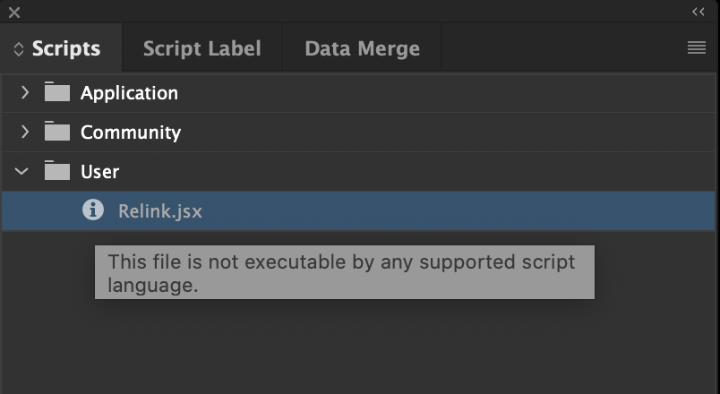

Ok, I see now. I've followed the instructions and used TextEdit to save the script, but it doesn't seem to work. I guess maybe I'm doing something wrong?
Copy link to clipboard
Copied
Hi Jon,
did you save the script with TextEdit app as Text only?
If yes, we have a serious problem with Catalina and ExtendScript scripts in the User folder of the Scripts folder:
In previous versions of OS X a *.jsx file was considered to be owned by the ExtendScript Toolkit app ( ESTK ), but now with OSX 10.15 the ESTK cannot be installed anymore, it is 32-Bit software, so my assumption is that a jsx suffix will not be recognized anymore as what it is, a script that could be run with InDesign ( or other CC apps like Illustrator, PhotoShop etc.pp. ). Usually a orderly saved ExtendScript script that lies in the User folder of the Scripts panel should run with InDesign. Maybe that changed with Catalina? That would be a serious bug with InDesign.

I thought I had saved it as text only but obviously not! I just tried saving the script again and it worked! I must have done something different as the original file that didn't work has 'TXT' in the icon and the new one doesn't.
Thanks, everyone for you help. It works a treat and will save me a lot of time in the future!

Sometimes by default, TextEdit can be set to do the text in RTF format, which would mess up the .jsx coding. To ensure you have it correct in the future, in TextEdit you'd select the text and go to Format > Make Plain Text just to be sure.
Copied
I did actually have the format set to Plain Text. I worked out that in the Save dialog box, I should have 'un-ticked' the option to use .txt if no extension is provided, even though I did put .jsx at the end of the filename when saving.
