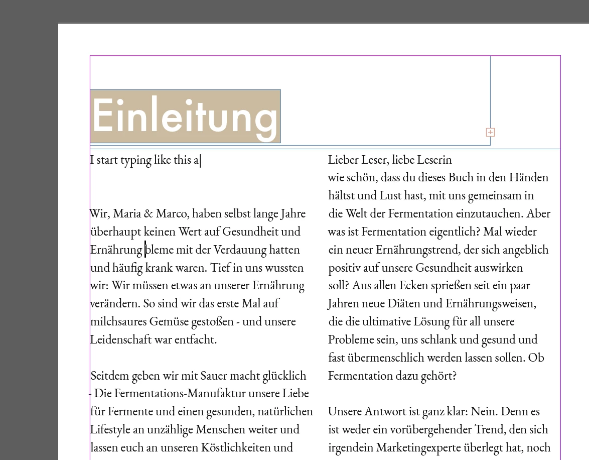

Hi everyone, I have inserted a piece of text by placing a .doc file using the "Place" feature. When I try to change to a two column layout, either using "Text Frame Options", or "Split columns", the order of the text is broken, the beginning if the text goes to the right column instead of left.
If I just copy and paste text then all works fine.
I tried the Type/Story window but I see no option to reverse direction there.
This is the correct order: (I inserted text manually)
Here is the wrong order that appears when I try to format a piece of my flowing text (inserted via "Place file) via .doc file)

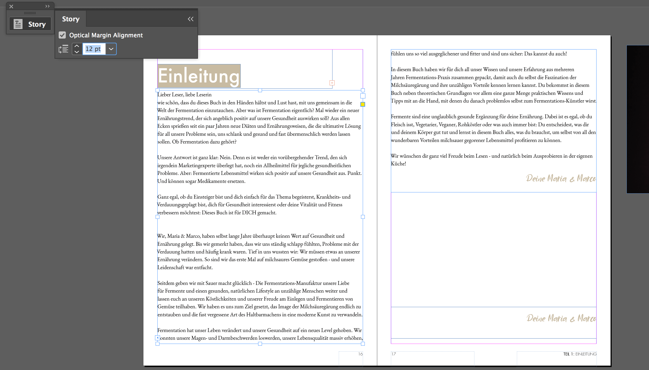

Nothing seems to be in the "Story" window:

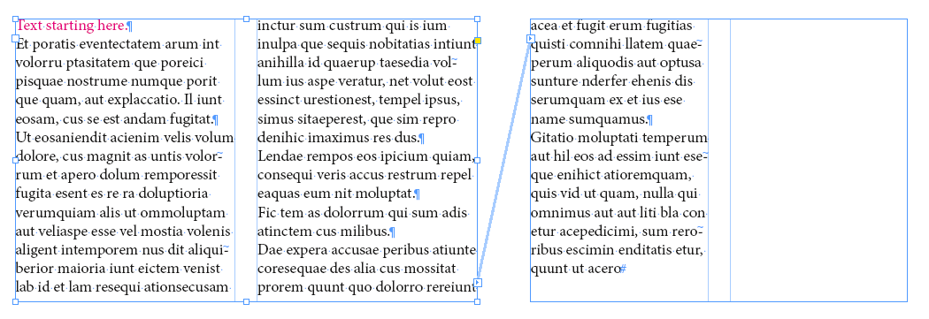

    How do I flow text from one page to another?
    It looks like the problem is about wrong order of columns. Text is still left to right:
    EDIT: thanks soooo much for your help anyway!
    Click on the out port (the small square in the lower-right corner of the frame using the Selection tool. Your cursor will load, now just move to the next page and click in the upper-left corner of the page (where the margins intersect) to create a new frame. Those frames should be linked together and if the left to right is maintained, you should see a small square in the lower-right corner of the frame that you just created. If this works, repeat the process but on the next page, hold down the shift key with the loaded cursor and it should auto flow for you. This could be achieved using the Primary Text Frame feature as well, I'm just trying not to create new variables at this point.

    interesting "story" this is, I suppose the story's storyPreference storyDirection property is set to StoryDirectionOptions.RIGHT_TO_LEFT_DIRECTION by the Word import.
    You already solved the problem.
    However this also could be done by scripting the story of the imported text right after importing the Word document.
    Select the text frame with the wrong order of columns and run the following ExtendScript ( JavaScript ) code on it:
    app.selection[0].parentStory.storyPreferences.storyDirection =
    StoryDirectionOptions.LEFT_TO_RIGHT_DIRECTION;
    alert("Done!");

    Before running the script code:
    After running the code:

    Your text frame is set up as a right-to-left text frame. (Take a look at where the out-port is in the bottom screenshot: it's at the bottom-left of the frame. In a left-to-right frame, it should be at the bottom right, as it is in the top screenshot.)
    To change this via the UI, you will need the Middle Eastern version of InDesign installed. From the looks of the Story panel in the bottom screenshot, it does not appear that you have this.
