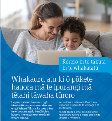

I have a 24 page doc consisting of basic text and images. Everything looks fine and there are no preflight errors. When I export to PDF the majority of the document is fine and then sporadically from pages 6-11 some text and photos go missing. I have cleared all preferences, I tried turning texted into outlines, I tried deleting images and exported to see if i could find a bad file. I've got nothing. Ideas?
When I view the exported PDF I get "An error exists on this page. Acrobat may not display the page correctly. Please contact the person who created the PDF document to correct the problem." I created the PDF and there were no errors.
What it should be:
What is exported:
(Renamed by MOD)

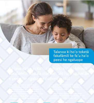

Here are two jpegs of the pdf exports. The correct one was done in 2019. The incorrect one was done with 2022. Both were exported with the exact same settings, only different programs.

For me the thing is clear. InDesign will export all items on the pages correctly.
It's the PDF viewing app that has its problems to view the image on the first page.
In your case the Preview App on macOS. With my tests the PDF preview engine with the Firefox browser.
When opened with Acrobat Pro or Adobe Reader on macOS or Windows all should be ok.
Uwe Laubender
