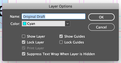

I found I had a similar issue but it was a hidden layer I had underneath that had an object with Text Wrap set (despite having hid that layer). What I did to fix this was, right-click on the layer for layer options, and selcted "supress text layer when layer is hidden", and it solved the issue of the text jumping around.
