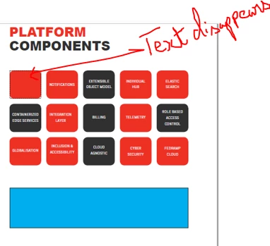

I am working on creating an interactive pdf... where upon clicking a button, a text box shows below.
Now i am facing some issues with the same.
I have a box (red) with some text overlay on it.  i have converted the red box into a button (just the  red box, not the text overlay of 'Alarms' has been converted into a button) so that when i click it a blue box shows below. now that functionality of hide / show is working OK. but the box / button that has the text overlay, 'Alarms', disappears when i render the InDesign docuemnt into a PDF.
i am not sure why this is so. any guidance on how to fix this would be appreciated.

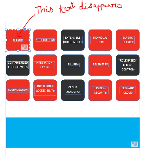

    Hi there, if you don't want your button to disappear make sure to set it visible in your button and forms settings. I hope this helps.

    I just ran into the same problem. What seemed to help is placing the text for the button into the button rectangle. You might have to finetune the vertical alignment to make it look good.

    Multi-state buttons won't work in an Interactive PDF, use simple button hyperlinks.

    Can you check with the layers position or overlapping issues may happened, check it once again.
    share docs for more clarity.

    thanks Kathir7. i have checked the layers panel and it seems OK to me.. the 'Alarms' textbox is over the red box/Button8. Also, as a sidenote, i wish to know is there a way to view all the buttons in the InDesign document.
