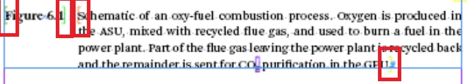

in the attached image  figureElement.XMLElements(2) is (Figure 6.1 Schematic of an oxy-fuel combustion process. Oxygen is produced ). I have to read the Fignumber and matches the text within the frame or not. it is in (A simple block diagram representing the main components of oxy-combustion can be observed in Figure 6.1.). When I manually remove the ^I in find it finds the text. But i have to do this via code.

As per your screenshot - (Figure 6.1 Schematic of an oxy-fuel combustion process. Oxygen is produced ) - is an XMLElement - that is build from TWO sub XMLElements:

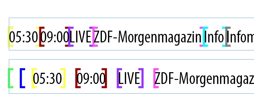

If you go to your text, put cursor before the "Figure" word, then keep pressing right arrow and pressing space:
>,space,>,space,>,space,>...
you will see that those XML markers start separatting - right now, you have at least TWO XML markers on top of each other:
So, instead of trying to split "dirty" text contents of the figureElement - just get a reference to its 1st Child - the same way as you are getting FigCapElm - 2nd element of the figureElement - I don't code  in VB.net so just guessing:

Can you upload more screenshots from your text - in the InDesign - with Hidden Characters Visible.
Figure 6.1 is read from indesign.xmlelement. But it came with ^I. sometimes it is ~I. My input xml is
<title aid:pstyle="FigCap-1"><!--E--><FgN aid:cstyle="FgN">Figure&#x00a0;6.1</FgN>&#x09;<!--/E-->Schematic</title></figure>
