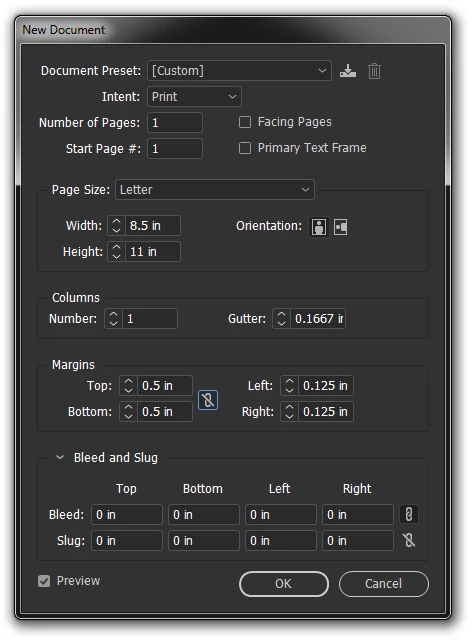

    1. 8164 is a letter-size page with 1/2-inch margins top and bottom, and 1/8-inch side margins like this:

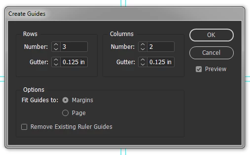

    2. With that page setup, choose Layout > Create Guides and use these settings:

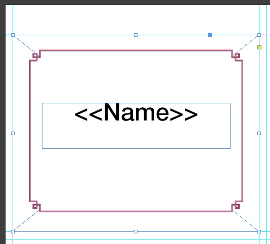

    3. Set your content with Data Merge field(s) within the TOP-LEFT 1/6th of the page:
      TIP: Setting a frame that fills the guide-demarked space as shown (selected) makes multi-record layout easier in later steps.

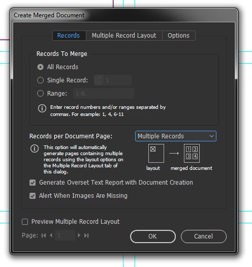

    4. Choose Create Merged Document from the Data Merge panel menu.
    5. In the Create Merged Document dialog, set Records Per Document Page: to Multiple Records

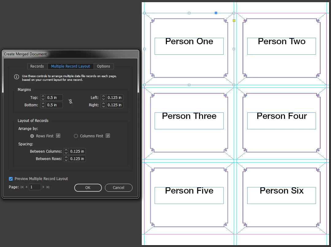

    6. On the Multiple Record Layout tab, set spacings to match your template:

    There are Avery 8164 templates available, but for the most part, they won't help much, and multi-record Data Merge can be confusing until you fully understand the way it works. I'll try giving it to you step by step:
