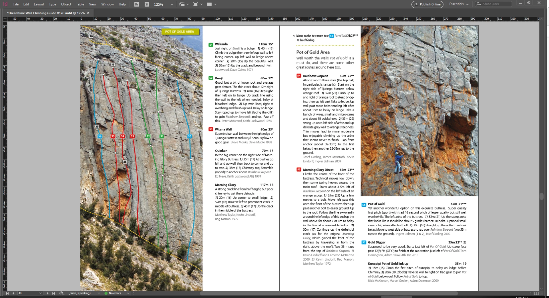

Maybe a screenshot will help show it a bit better in the page layout context (see middle right of this spread):
I have formatted the first line (route name, length, grade, stars) with a paragraph style, and can generate a table of contents with the page number and this line of text, which is great, but... the new Moonarie (South Australia) book is going to be around 1500 climbs, so manually separating/formatting the spacing between the route name ("Pot of Gold"), route length (62m), grade (21) and number of stars (***) is going to take FOREVER. I also need to work out a way to grab the area (which is a paragraph style header currently).
