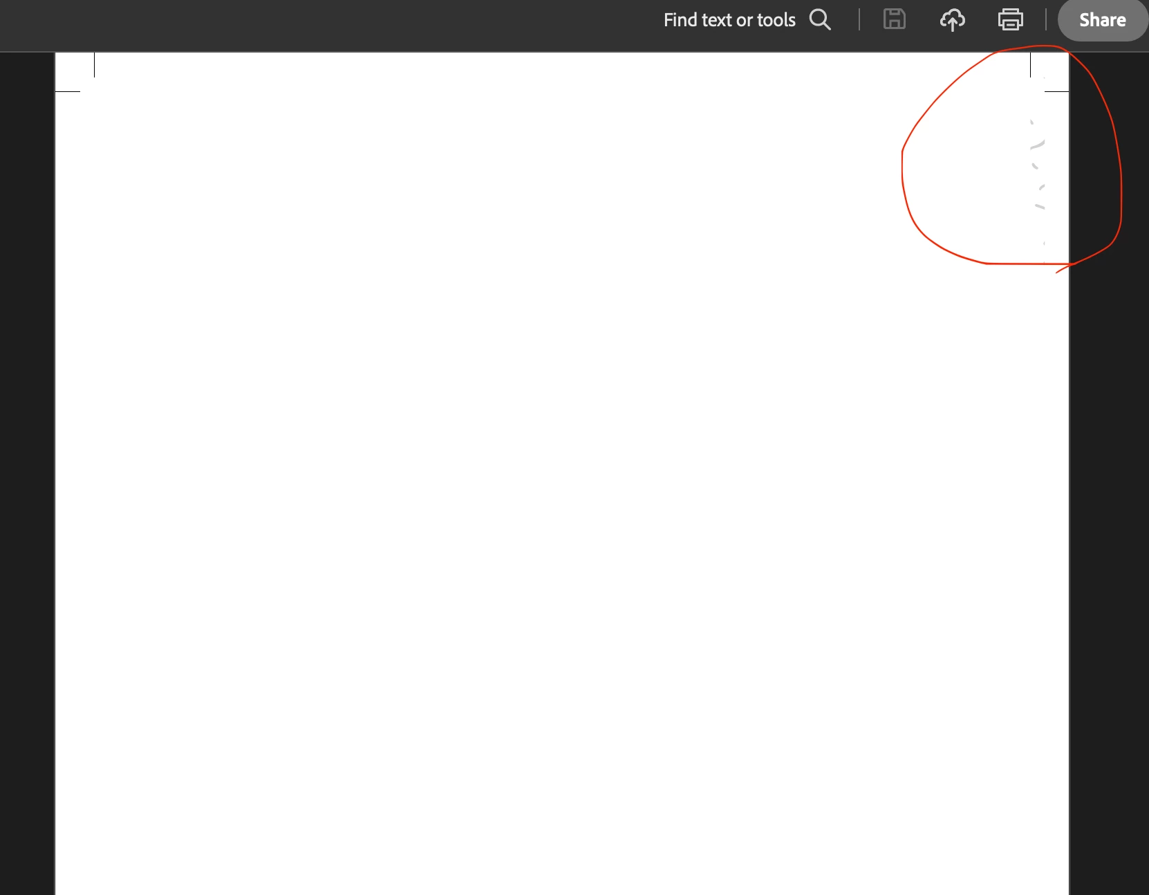

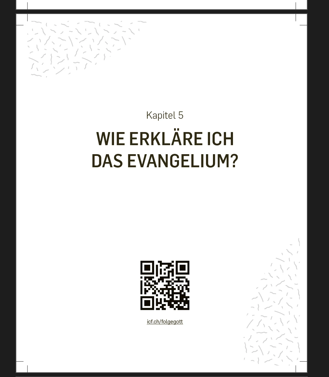

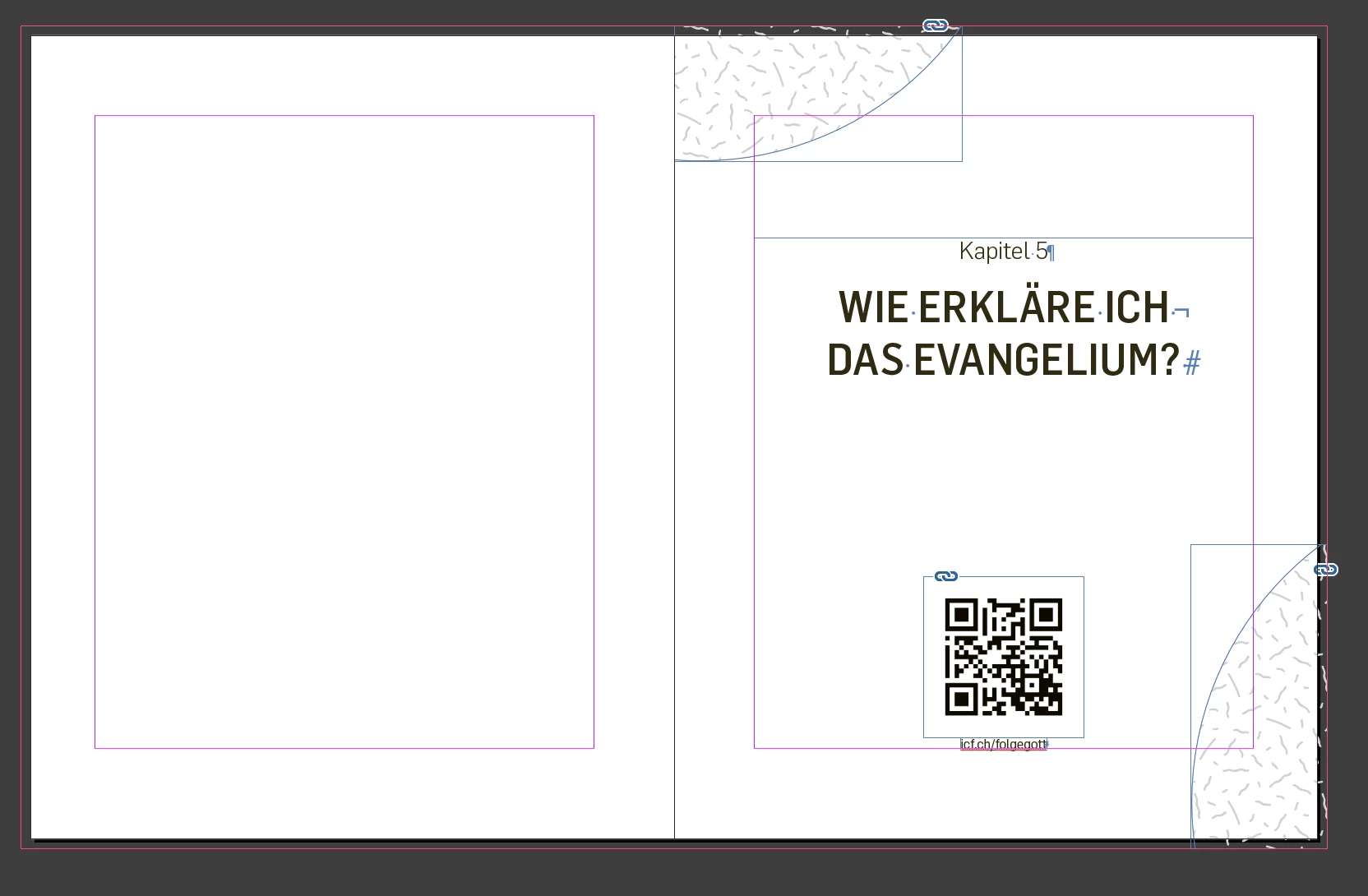

I am at the end of my book project and have prepared my books for export using a PDF preset from the printer (FM_Text_FOGRA52). For some reason, on the first page, it includes some of the graphics from page two. If I export without the PDF preset ([PDF/X-1a:2001]), this doesn’t happen.
As you can also see in the image below, there is nothing on page one, so I don’t understand why this is happening when I export it. Is this a common issue? Why might this be happening?
Thank you very much!

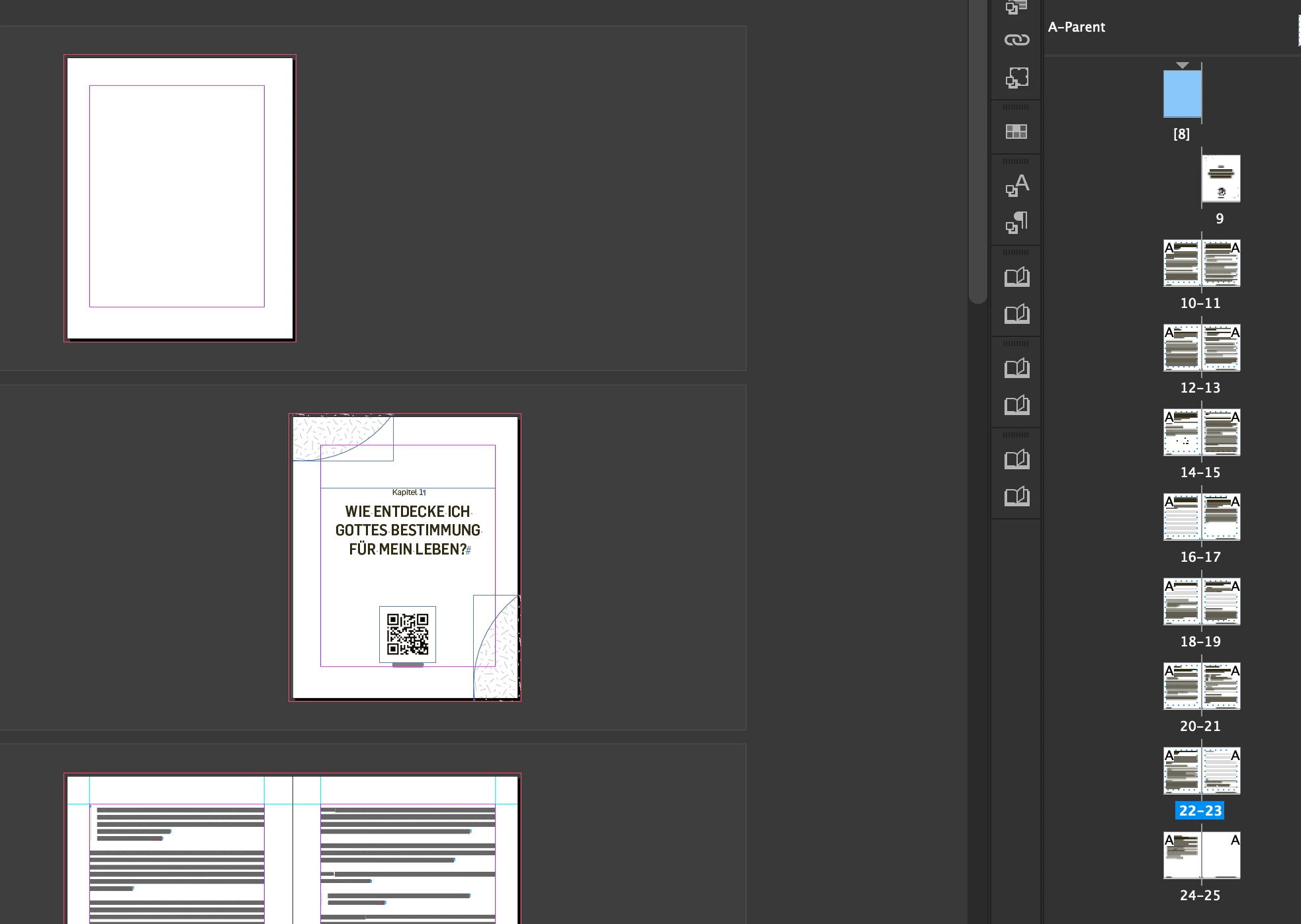

@Peter SpierI tried the second option, and it seems to work. Is it normal for my page to look like this now? Could it cause any issues I should be aware of?
@Mateomono Yes, the screen shot shows how a split spread should look.
As @Scott Falkner the inside bleed (this is the bleed between the two halve of a two-page spread) is generally not a problem for most binding methods, but it can occasionally be revealed when creep is added to the pages during imposition of a signature containing a large number of pages, or for spiral-type binding. Unless you split the spread, as you've done, the inside bleed area is actually the edge of the opposite page. By splitting a spread you are now able to drag your bleeding content out into the inside gutter area without it being picked up on the opposite page.

This is not a problem. You are seeing items from the adjacent page because you included bleed. Your printer will impose the book, placing the left-hand page against the appropriate right-hand page. The bleed will either not be included or will be removed if they are using proper imposition software or plug-ins.
Think of a four page booklet that’s 8½″ ⨉ 11″ printed on 17″ ⨉ 11″ paper. The front cover will be printed on the same side as the back cover. Anything that bleeds to the left of the front cover will not print since the final imposition will place the front and back covers against each other.

Peter Spier
March 28, 2025
This is generally caused by having an inside bleed setting.
You can either set the inside bleed to 0 or you can split the spread by selecting it the Pages Panel and unchecking Allow Selected Spread to Shuffle, the selct only the right hand page in the panel and drag it to the right until you have independent pages showing in the panel.
