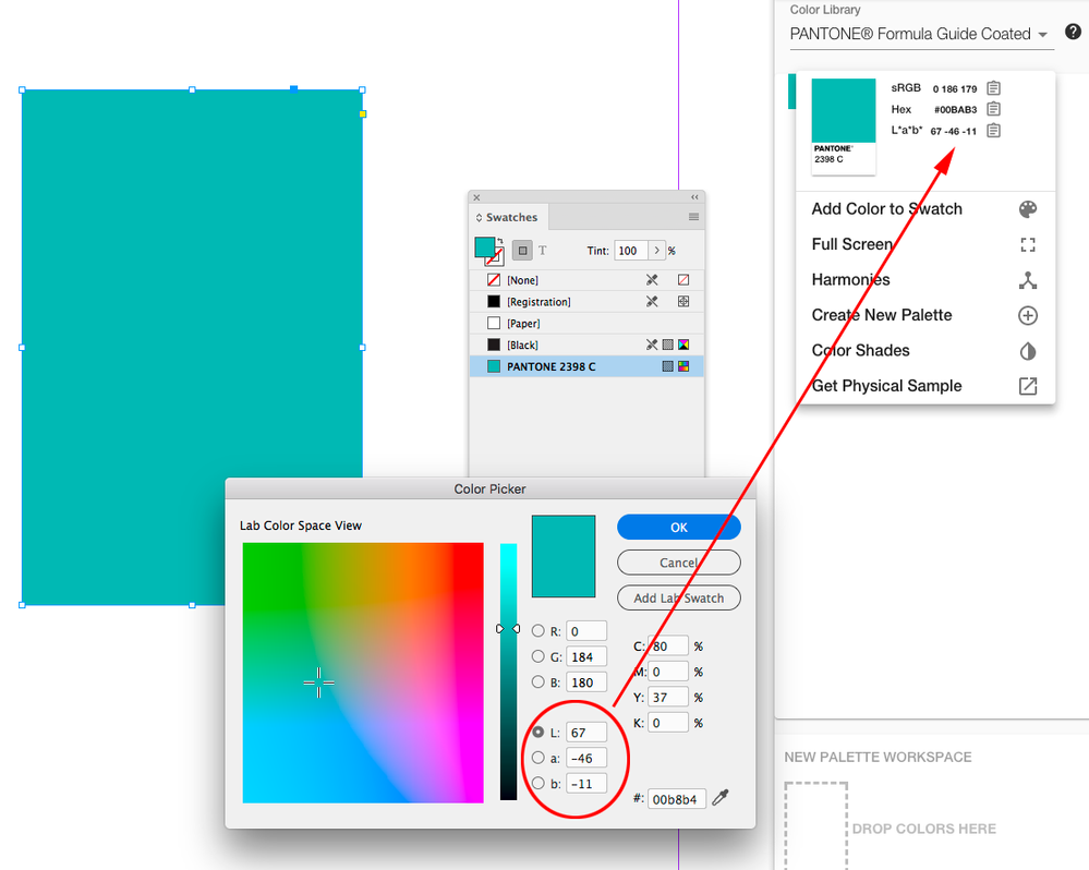

The Pantone Coated solid ink colors are defined as Lab, so the Lab value listed in the Pantone Connect Extension is the actual color you will get when you add the color to your Swatches panel.
The sRGB and Hex values listed in Connect would be Pantone’s suggested conversion from Lab into sRGB, but there are a number of color preference settings that would affect the conversion if you make it with a CC app— Pantone doesn’t let you know how they make their conversions.
Changing the document’s assigned RGB profile, or the Conversion Options in Color Settings (Intent, or Engine) would affect the RBG or RGB Hex conversion numbers you get in the Color Picker. If I open your color in InDesign’s Color Picker,  the Lab values exactly match the Connect Lab values. The RGB, Hex, and CMYK values are color managed conversions from Lab color based on the document’s assigned color settings:

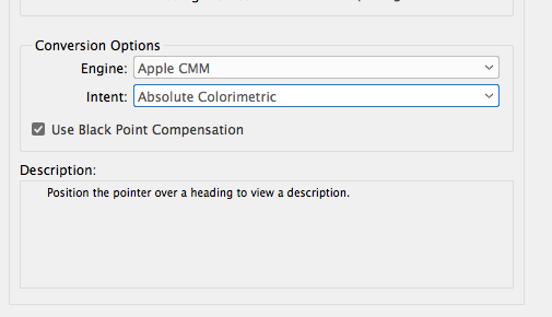

If I open Color Settings and change the Intent and Engine, it affects the RGB conversion numbers:
