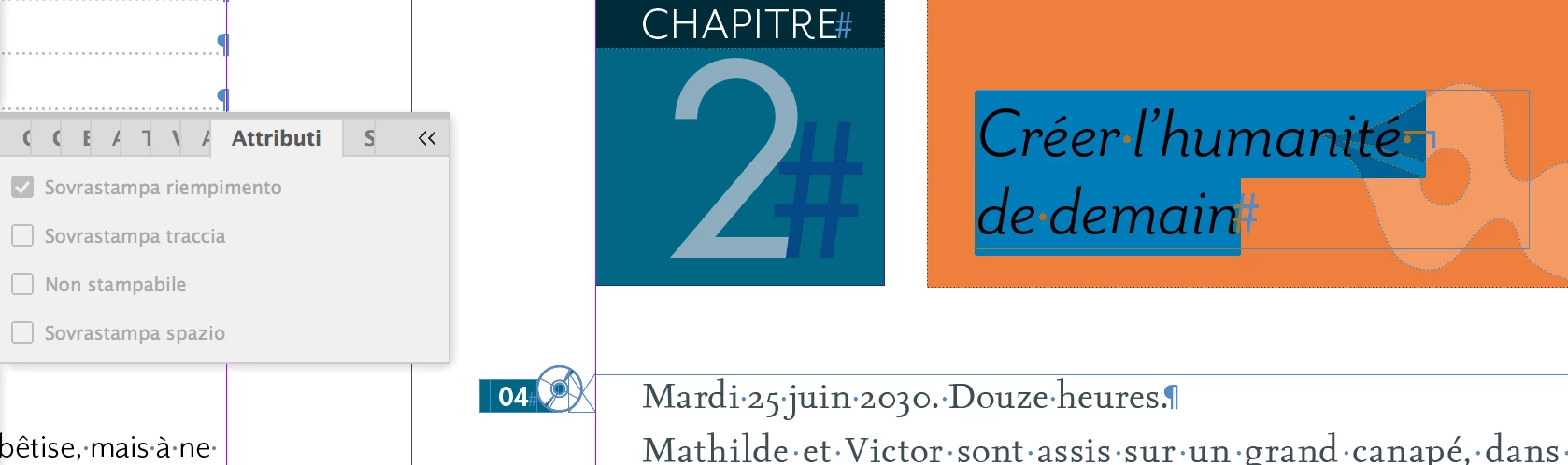

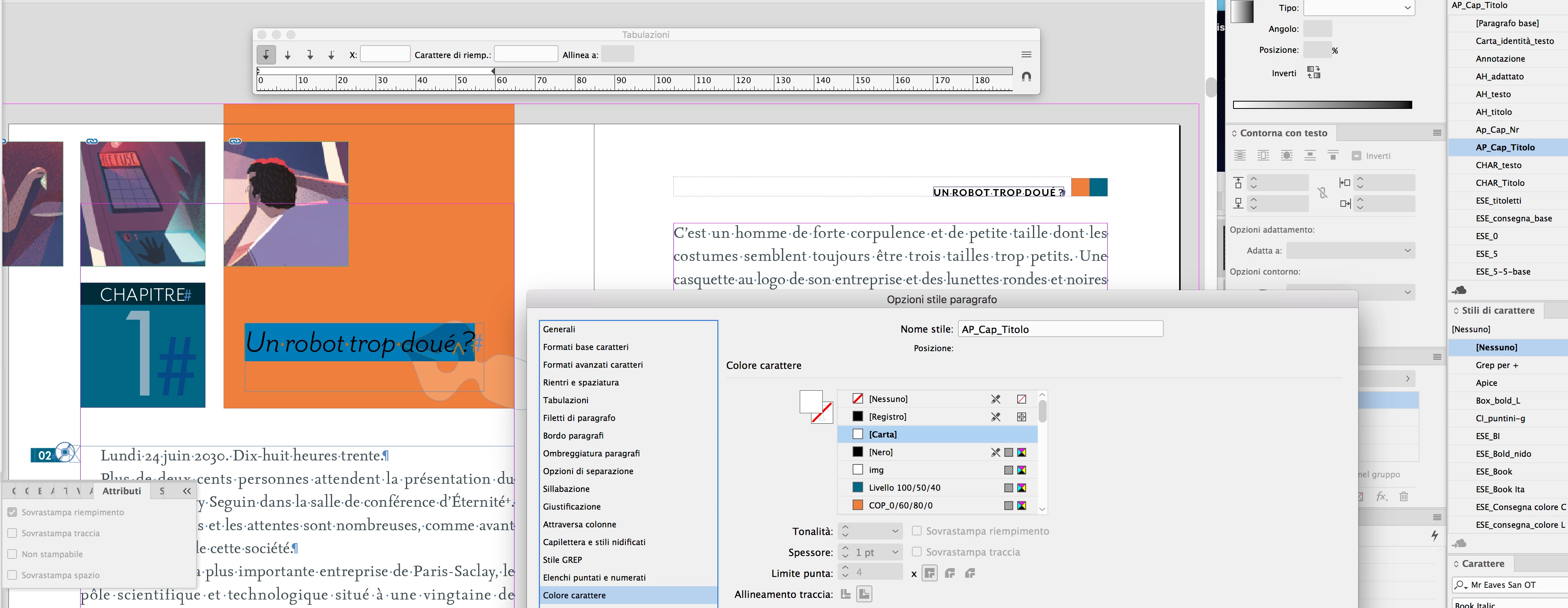

So, here is my (sad) story: a book printed with no titles at all, a second book printed with random words of the titles (white titles on an orange background). The paragraph style sheet has correct overprint settings, the text box in the master page has correct overprint settings. If I select the text box in the regular page the overprint settings are correct, but if I highlight the text, in the Attributes panel 'overprint filling' is checked in pale gray so that I can't change the attributes. If I select and move the box forth and back, the overprint check disappear. Any suggestions, except an exorcism? I have to explain to a customer why his production of graded readings, this year, would be taken to waste without losing his confidence.

I can recreate the issue by applying a character style where "overprint fill" is checked.
You can check that out.

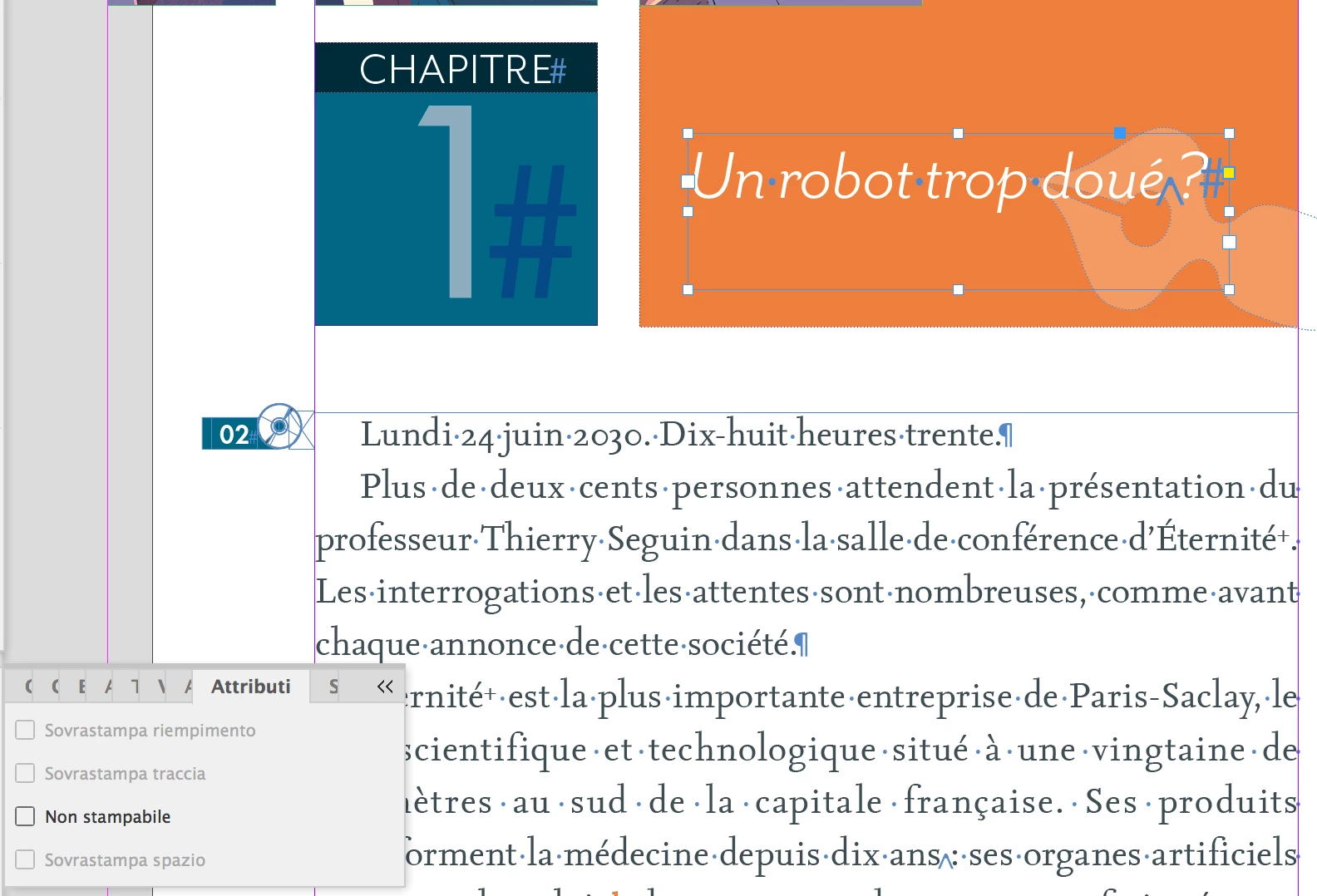

If no, select the text frame and check the attributes of the text frame.
Window > Output > Attributes
Could be that it is set to "Non Printing".
EDITED:
Hm. Your screenshot is showing that "Non Stampabile" is not checked.
Maybe there is in an effect applied to the text of the text frame like "Multiply" ?

thanks for your reply. It's an overprint issue so if I select Overprint preview I can't see the text. But what I'm trying to understand is why it occurred as I haven't changed any options and every year I use a previous printed file of the same editorial series (to maintain master pages, style sheets, etc) for the new ones.
If you look at the screenshots, the first one shows that in the Paragraph Style sheet the overprint is correct, but in the Attributes panel it is not (and it is unmodifiable, pale grey).

I can confirm Vinny's #5 example where there is a Character Style set to Overprint but no color chosen. That allows you to Overprint the Paper swatch which is typically protected from overprints:
It may be that your previous pre press person disabled any overprints from the RIP. It's not unusual for printers to prevent any color other than Black from overprinting for exactly this reason. If I'm trying to overprint a color for an effect, I'll use the Multiply effect, so I don't get in the way of the trapping.
