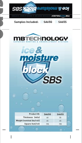

In this example, the six gray lines at the top are outside of the artboard, yet they show up when this was exported.

    I now realize the first image I posted is a little confusing.
    That was a screenshot of a PDF I didn't export.
    I made updates to the original document and want to export it just like the original PDF.
    However, when I export, it comes out different. (Without the gray lines)
    The left image is what I exported. The right image is how I need it to be.
    Preferably without using slugs.
    Luke Jennings
    July 10, 2017
    The difference between the two PDFs is the one on the right was exported with a larger crop mark offset, possibly .5". By using a larger offset, the PDF media box size was increased (not the trim size) and the extra lines were revealed. The crop mark offset should be at least as large as the bleed amount. BTW, in Acrobat you can view the PDF Art, Trim & Bleed boxes by going to Preferences> Page Display> Show art, trim & bleed boxes.
