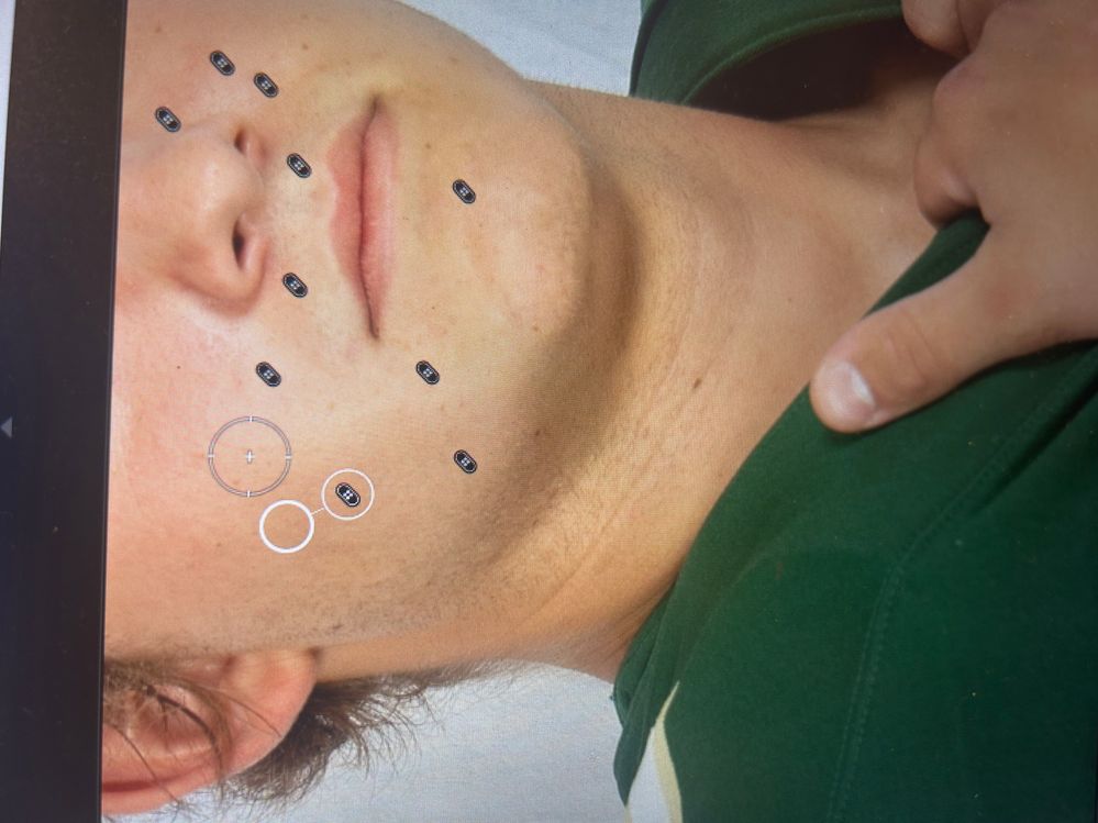

Community Beginner ,
Aug 07, 2025 Aug 07, 2025
Okay, a quick update. I just worked through 20 photos of football players and what I discovered is that as I moved from one photo to the next, the cursor radius increases from the size I had on the previous photo, but the actual size that is sampled is smaller than the cursor indicates (it was whatever size I had on the last sample of the last photo). If I rotate my mouse wheel one notch, it reduces the cursor radius to one notch smaller than the size I just sampled on the last photo. From that point, it stays the correct size for the rest of the time I am working on that picture, even if I change the size (again, using the mouse wheel). Below is a screen shot to illustrate. You can see that the cursor size is larger than the most recent spot that was "healed," but that is the size that it was when I clicked to heal that spot. Once I resize the cursor, it stays the correct size until I move to the next photo, and then I have to resize it again to get the cursor and the actual sample size to be the same. It's definitely better than it was before, but still not ideal. Note: all of these photos are rotated because they were photographed vertically. IMG_0547.jpg
