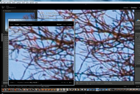

"Why will the primary monitor display pixelation at high magnifications while the second monitor never shows pixels even at extremely high magnifications."
I am not actually able to reproduce this problem. Neither the primary nor secondary monitors interpolate at high magnifications in my testing. Can you provide some info about what Lightroom version you're using, what operating system you're using, what file type you're using, and any other relevant info you can think of?

Here's a screenshot from my Windows 7 system that displays the "softness" jpowens refers to in the secondary loupe image at 8:1 Zoom View. It can be demonstrated on my single monitor system.

The issue I see is not addressed. The second monitor image is not the same as the primary. When zoomed in the secondary monitor does not and never will show the pixels. This tells me that this is a rendering of the file at various magnifications. The image on the primary monitor does show the pixels.
I want to see the same image on the secondary monitor as the primary down to those tiny pixels.

Participant ,
Jun 19, 2014 Jun 19, 2014
