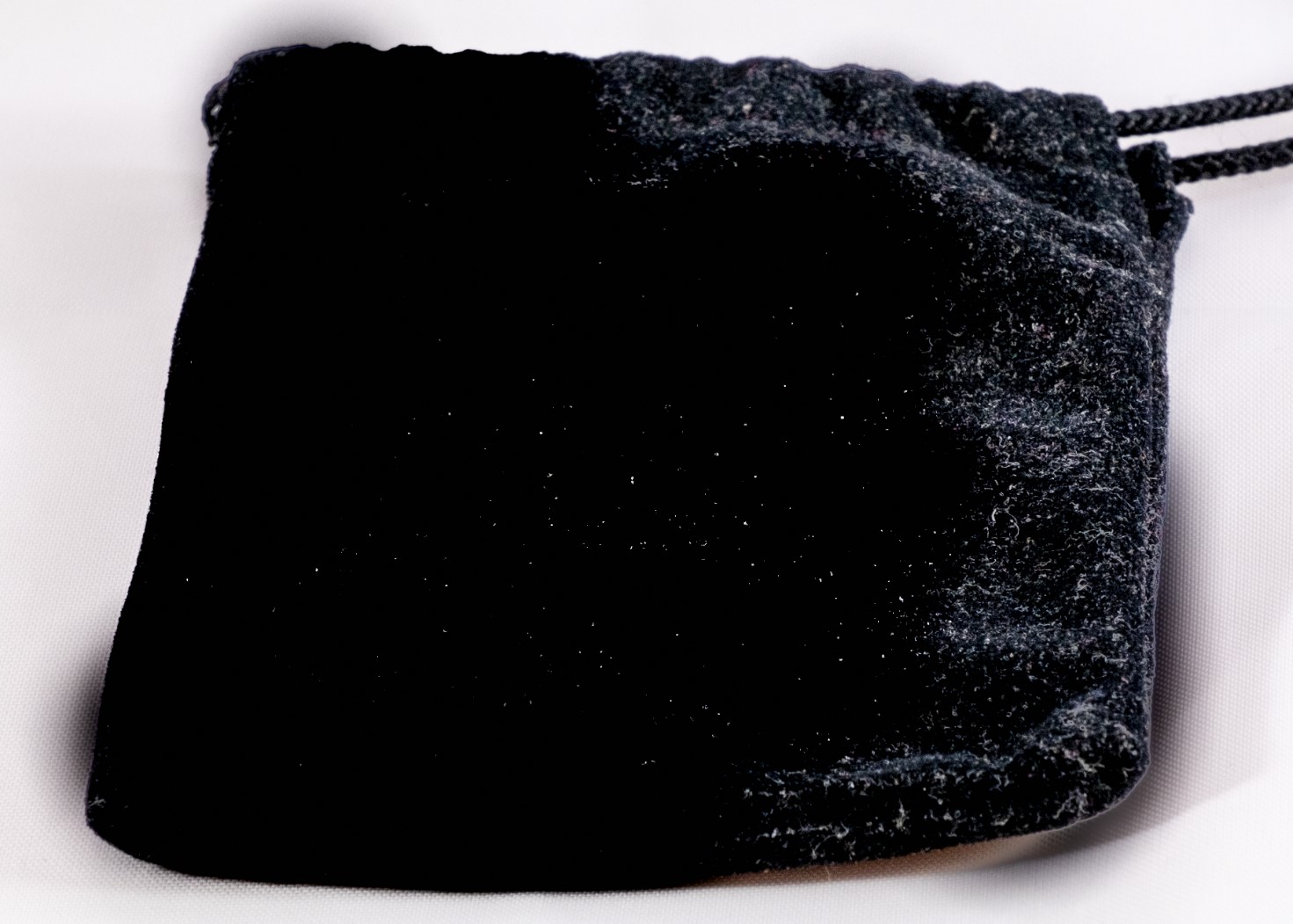

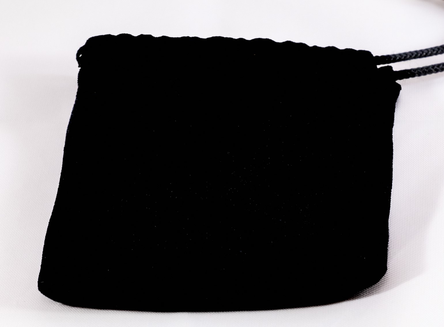

Overview
  1. very slow, about 2-3 seconds per spot vs instantaneous on V9.4
  2. like was reported for MacOS users, removing a spot undoes a brush stroke
I've been trying to recreate the MacOS problem on Windows and finally did it by accident. This is a freshly imported image. Below are screen captures:
  1. before brush
  2. after brush
  3. after removing one spot
    Depending on the spot, different areas of the bag are affected.
Just FYI, this is a velvet bag for a Sony headset that could find lint in a NASA clean room.

Update:
  1. exported image 2 as a 4K jpeg
  2. imported jpeg
  3. performance restored, instantaneous spot removal
  4. excellent results
So the trick (technique) until we get a fix:
  1. perform all edits except spot removal
  2. export image as a jpeg
  3. import
  4. remove spots
