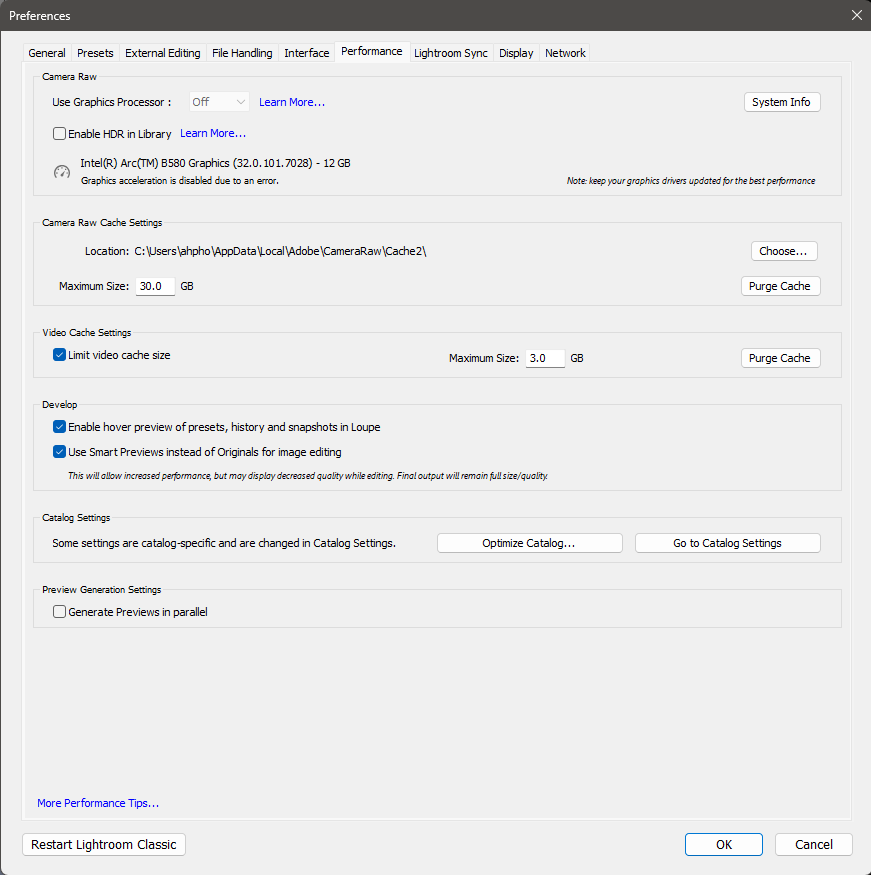

@andre29143016m9nk: "If I go to preferences, even though the GPU use was set to AUTO, when the error occurs, it is now changed to OFF with no option to turn it on."
Please do the LR menu command Help > System Info and copy/paste the entire contents here so we can see exactly which versions of hardware and software LR thinks you're running and important LR options that are set.
Also, please post a full-resolution screenshot (not a phone pic) of Preferences > Performance.
Community Beginner ,
Sep 07, 2025 Sep 07, 2025
So the plot thickens.
I am not currently using version 14.5.1 because it is much slower than previous versions, so I reverted to version 14.4. Even after that, the problem of the exclamation point persists. Guiding you step by step:
1- All looks well, and GPU is on auto
2 - I do a object selection mask, or sky mask, there is a moment where it is creating the mask and then no mask is created and the image gets the exclamation point
3 - I go to preferences and GPU is turned off.
