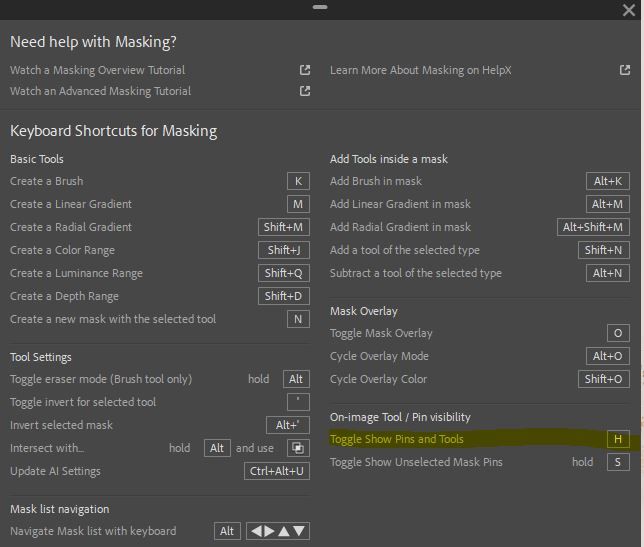

To make it a little clearer, in case it helps: Lightroom Classic gives you two places to control the visibility of the edit pins for a radial or gradient mask: On the Show Edit Pins menu in the toolbar at the bottom of the Develop module when the Masks panel is open, and also from the menu bar on the Tools > Tool Overlay submenu. Both are shown in the picture below, and both control the same setting, so for example if you change it on the toolbar, that changes the selected command on the Tool Overlay submenu.
If the toolbar is not visible at the bottom of the Develop module, choose View > Show Toolbar.
If you want to know the keyboard shortcuts for the Tool Overlay visibility commands and Show Toolbar, they’re shown on the menu next to those commands. A lot of people use the single-key H shortcut to cycle through the modes, and the T shortcut to toggle the Show/Hide Toolbar command.
July 12, 2023
Press H to show the pins again which allow you to rotate or move your masks
October 17, 2023
Thanks that works I had the same problem as the original poster

Is the mask still selected?
Is the Tool Overlay (left below the image) set to be visible?
If you do not see the overlay settings at all, the hit the T key to toggle the visibility of the Toolbar.
-- Johan W. Elzenga
July 27, 2022
i believe the mask is still selected because i am able to apply effects.
Ah, it's the edit pins! thank you
