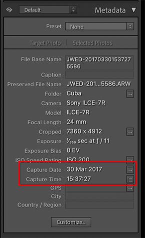

The screenshot shows 12:19:05 as the time, and that is exactly what you wanted to achieve, so it looks like the change was successful... I think you are looking at the wrong EXIF field in the right hand corner, just like @richardplondon suggested. There are many date/time fields, and this is not the correct one. Click the 'Customize' button and find the Capture Time field, not this 'Time' field (which I assume represents the file creation time).
-- Johan W. Elzenga

BTW, I just tested it and the 'Time' field that the OP is looking at in the metadata panel is the file modification time, not the capture time. That explains why he does not see any change after changing the capture time.
-- Johan W. Elzenga
