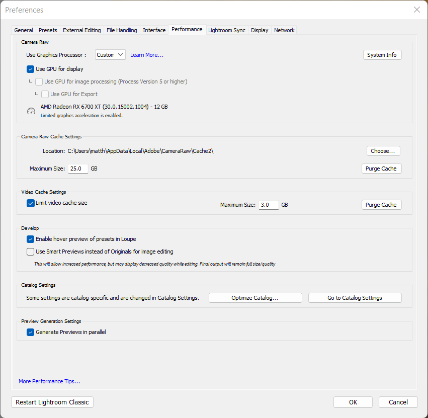

I'm not sure if this would be chalked up to be a bug, configuration issue, or incompatible hardware. I'm generally good with solving issues such as this but I'm stuck on this one.
Scenario:
I was excited to read about 11.4 adding GPU support for Exports. I was digging around the Performance tab and then see that Lightroom is not fully utilizing my GPU.
General System Specs:
AMD 5600X
AMD 6700XT
64 GB Memory
I am using Ryzen Master to OC the CPU and am applying an undervolt to the GPU via Radeon. I've set both of these back to default as well as updating the Radeon software/drivers. So far, I have not found a fix.
Curious what do try next.
Here is a PasteBin of System Info as exported from Lightroom Classic 11.4. I've also attached two screenshots detailing the issue.

I tried these steps exactly and I'm in the exact same place.
For some reason it's failing the self test.
Has this been verified to work correctly on Windows 11?
Does Ryzen Master and/or Radeon Software potentially cause issues with either overclocking the CPU (Ryzen Master) or undervolting the GPU (Radeon Software)?
I've noticed if I go into the GPU file I can "force" it to work by claiming that the test passed "True" instead of "False". When I do this, I can definitely tell that the GPU is in use and I can enable all custom function. Any reason not to do this?

You're attachment shows your graphics chipset is AMD Radeon RX 6700 XT, driver 30.0.15021.11005 (22.5.1). You could try the latest drivers (Adrenalin 22.5.2 or Pro 22.Q2) or rolling back to a driver from last year (e.g. Pro 21.Q2). That hasn't worked for another person, but it might work for you.

I just installed the 22.1.2 driver from January 0f 2022. Upon installing and deleting the GPU and LOGS folder, I opened Lightroom. Although "Automatic" only enabled limited accelleration, "Custom" allowed me to check all the boxes.
Of course, when I checked the log, it showed that it passed the self check.
So, in this scenario, the fix is 6 month old drivers. Is that typically something that is up to AMD to fix to become compatible with Adobe, or up to Adobe to become compatible with the newer AMD drivers?
