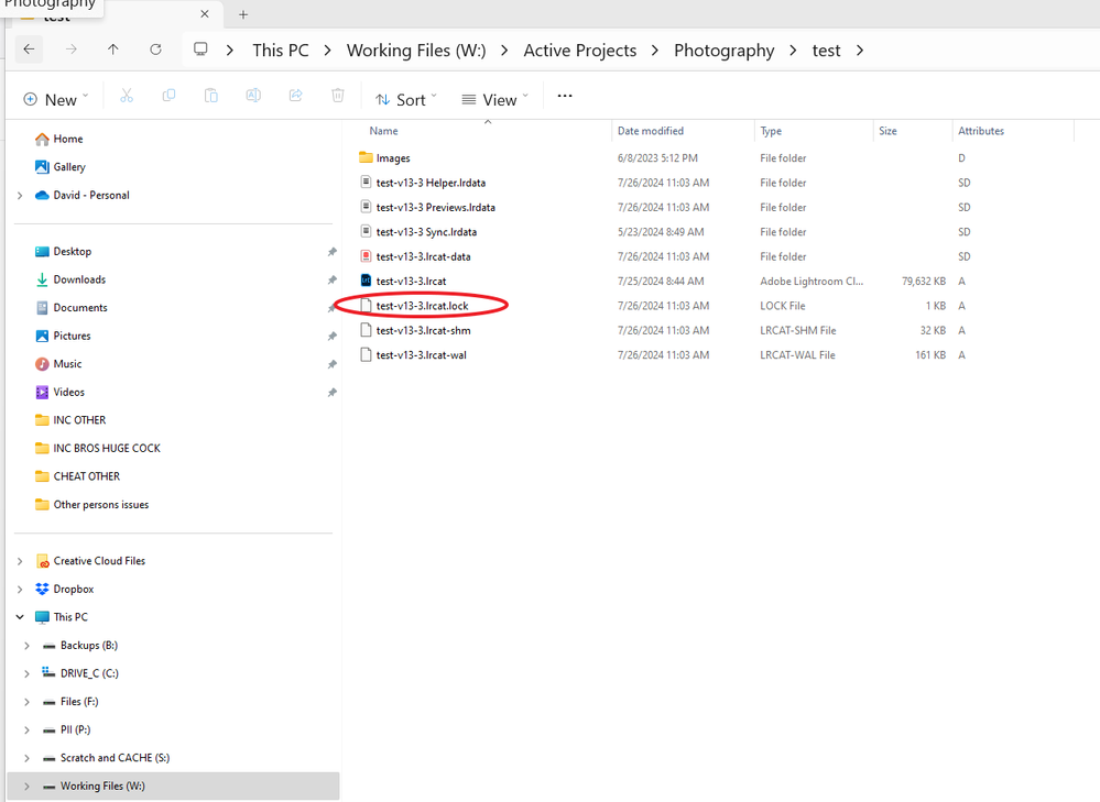

I am experiencing the same issue. Last weekend I edited images in LrC with no problems, yesterday I tried to open LrC and it doesn't open, just shows up in Task Manager.
I found old threads from 2023 which mentioned the metrics.json file that GoldingD has mentioned, however, I don't seem to have an App Data folder in the location they say to look for it.
I've just tried deleting the lock file that was also mentioned, that hasn't solved the issue.

This should not be the issue. You should get an error message if it is. But...
Using Windows File Explorer, bring up the folder your catalog is in, and see if a lock file exists. This lock file should only get created upon LrC start, and deleted upon LrC close. It will not get deleted if LrC crashes, or you force quit LrC. It exists to prevent more than one instance of a catalog being open on a computer at one time. You should get a error message if it exists, but...
