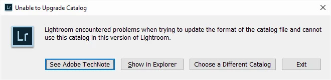

Just upgraded to Lightroom Classic CC. When I try to open my main catalog, I get notified that it needs to be upgraded. When I try to upgrade it, I get this:
I've tried and failed 3 times already. Someone help me resolve this before I get violent. I'm really not far off from that point.

Hello rawgore​,
I had the same issue when upgrading the library. After trying several times and removing the library lock file, without any result I came up with the idea, that Lightroom is probably checking files. Since all my media is on various external drives I connected them and started again with upgrading the catalog.
And Finally it working without any problems.

jsu9re
November 11, 2017
I had the same issue: Adobe introduced Lightroom Classic CC as new version (update) from earlier version, when I tried running for first time said that library needs to be upgraded, but that kept failing time after time, meaning I no longer was able to open Lightroom at all.
THE SOLUTION in my case: I noticed that when the library upgrade starts, a plugin (in this case Loupedeck) appears into processes list in task manager. I kept killing that process in task manager as often as it started again, until the database conversion was successfully completed, then let that plugin start freely. That was the trick in this case -- the upgrade worked on first try.
October 31, 2017
I obtained a fix idea from another forum. So - probably due to some of the add-ons (and their collections), something was breaking during import obviously. I did an export to catalog for my entire catalog (no negatives), then did import with a new catalog in CC classic. It went in (kinda quickly...). Now deleting old smart previews and building new ones... I did an optimize after the import and it went off without a hitch, so I'm hopeful the trouble is behind me.
October 30, 2017
I am having the same issue. Tried opening it directly and converting (fails with the same error). Tried creating a new catalog and importing from catalog (it fails). I opened it in Lightroom CC and tried twice to optimize the catalog before converting. No luck. I tried adding a few photos, then optimizing. Still no luck directly opening or new catalog and import.... Any other ways to make the $10 per month remotely worth it?

forsthof
October 22, 2017
I am having the same issue - catalog is on synology NAS.  I have disconnected/reconnected still the same issue as others...help.
Dave
rawgoreAuthor
October 22, 2017
Try copying the catalog file and directory (without the photos themselves if they reside elsewhere) to your local drive. Open it with Lightroom, let it do the upgrade, then move the upgraded files back.
forsthof
October 22, 2017
I rebooted and let the drive reconnect it finally worked...copying the catalog locally would have taken forever due to the size...

rawgoreAuthor
October 19, 2017
Thank you, that worked. I had to "safely remove" my external drive and then reconnect it, and the catalog upgrade went fine.
thallnersCorrect answer
October 19, 2017
Hello rawgore​,
