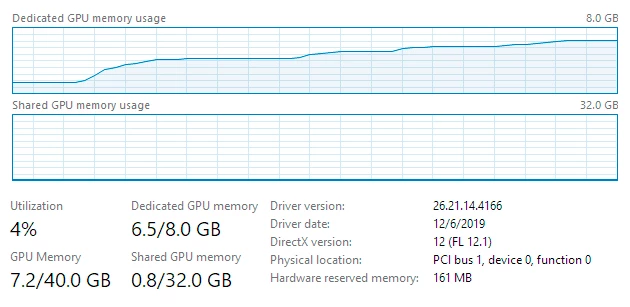

It's been months now and this issue is still causing so many problems.
Within minutes of opening Lr Classic and doing anything (grid, Develop, etc), all available VRAM will be consumed and most computers will become unusable if any other apps are opened which need to use the GPU.
People are increasingly complaining about Lr and system performance and this is the primary issue which is contributing.
Here's a SS showing what happens within a few seconds after you open Lr and develop a single image using only the basic sliders.
Does no one at Adobe care about this bug?
