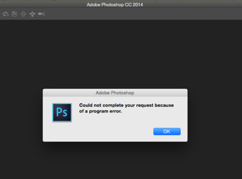

i keep getting this message when i try to do anything in photoshop a second time what i mean is when first opened photoshop works when i close the first image the go to do anything else i get the message: Could not complete your request because of a program error.i have uninstalled and reinstalled photoshop cc but no difference i have taken a couple of screen shots which i hope will give you more information
i hope you can solve this problem as i am at my wits end

Have the same issues after updating to 10.10.1 -I can open a PSD file on first launch..then after that receive the error message "Could not complete your request because of a program error." Removed preferences and same result. First file opens fine.... and thereafter no dice.

After I installed Mac OS Yosemite PS will only open ONE file.
Any subsequent files I attempt to open result in an error message "could not complete your request because of a program error' which then forces me to quit PS as I cannot open any other files.
Am dead in the water - how do I fix this?
