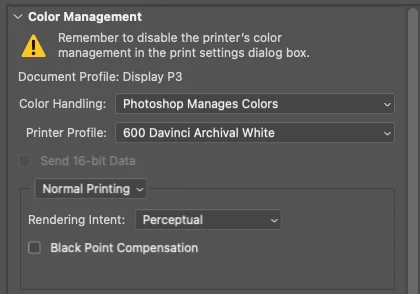

I've added a print profile for, Da Vinci Archival A3 Matte paper 315gms and even though I have that profile in my Printer Settings Profile, I keep getting a pop up window saying, 'The paper source in the print driver does not match the loaded paper'
On the printer display itself I have chosen, A3 Archival Matte and still no joy.
I've uploaded two screen shots
Anyone have any thoughts on the problem?

this is not a Photoshop ICC media profile issue. It's connected with the printer driver software, when you select media type the media feed method is set automatically.
I suggest Epson support should be able to help you.
Or the paper manufacturer who gave you [seemingly] incomplete instructions on how to use their media.

The alert message is not related to color profiles or Photoshop. It is related to which paper source (in the actual printer) that the current settings (in the Epson printer driver software, not Photoshop) are set to feed the paper from.
First thing to try is to check which paper source is selected: In the Print dialog box in Photoshop, click the Print Settings button to open the macOS printer settings. Look at Page Setup: Which paper source does it list?
If what you see there is not what you expect, click to open the Paper Size menu, and look at which one is selected. For Epson printers, the paper size choice might also list the paper source, such as Sheet Feeder, Manual Rear, or Manual Front. Choose the one you intend to use, then make sure that is where the paper is actually set up. We’re looking at these things because the message is talking about an inconsistency between which paper source the Epson printer driver is set up to find the paper, and where the Epson printer is actually detecting loaded media.
You should also check the printer itself. The alert message mentions the CD/DVD tray and the front manual feed tray. That means the Epson printer driver is getting a signal from the printer that the loaded paper source is different than what is chosen in the software. Check to make sure all of the media slots or trays you do not want to use right now are correctly stowed away, disabled, removed, or not loaded with paper, depending on which media source it is. Then make sure the paper you are using is actually loaded into the same paper source you selected in the printer driver software.
Your printer driver dialog box might look slightly different, because I am using an older version of macOS.

Right, as I mentioned in the last line of my reply, my dialog box does look different than yours. There are at least two reasons for this. One, I already mentioned: I'm using an older version of macOS. Two, I'm using an Epson 3880, which is a generation older than your 800.
But those differences don’t really change the diagnosis, because the error message is clear enough that the Epson software thinks it’s a media feed settings mismatch problem and not a color profile problem. That’s why Neil’s answer was the same as mine: Check the media settings.
If you are positive that the paper source currently selected in the software is the same as the paper source where the paper is actually loaded, then something is giving the Epson software the wrong idea. The printer detects the current paper source using a sensor or switch in the paper path, so if the error message is clearly wrong, you could try opening the printer and looking for maybe a dirty or blocked paper sensor, or a stray paper fragment or paper jam keeping a sensor switch stuck in the wrong position.
Those troubleshooting ideas come from having used Epson printers since the 1990s. Since Epson tech support is not being helpful, hopefully the paper supplier will have more and better ideas. At least make sure you have downloaded and installed the latest version of the Epson printer driver.

The Epson printers can be a pain with 'paper feed source' at times. It doesn’t matter to that, though, what specific media you're using, the issue is that when you choose the media type** the feed source is automatically set. I don't have that printer so can't give you any specific screenshots.
The ICC profile selected in "Photoshop manages color" has no bearing on the driver's paper feed - so you'd be having the same issue with an Epson paper with the name you've set in 'Media options' .
