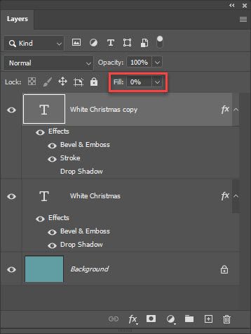

Nov 20, 2023 Nov 20, 2023
If you don't need to have the perspective and want to get close, here's one approach with 2 layers that each have their own set of Layer Styles.
I did the following:
  1. Set the text
  2. Duplicated the layer
  3. Applied Layer Styles to the first layer
  4. Changed the Fill on the 2nd layer to 0% (so that only the Stroke and effects on it appeared and not the text itself)
Here are the Layer panel settings for the layers:

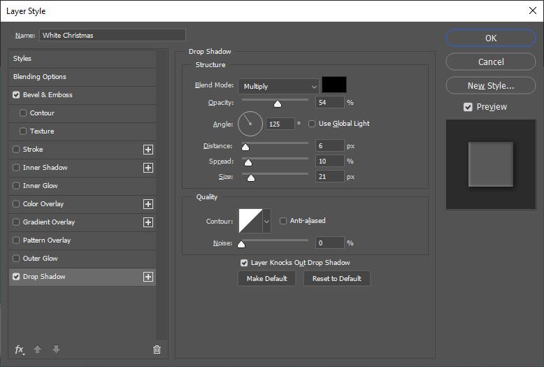

Here are my Layer Style settings for the bottom layer:
And here are my Layer Style settings for the top layer (I added the stroke first and then applied Bevel & Emboss):
