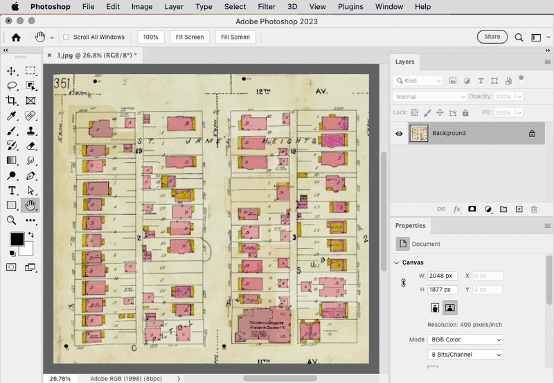

I am working with a scan of a 1911 Sanborn map, which appears much yellower in the scan than on the actual page of the book. When I adjust the hue to reduce the yellow, it really darkens/muddies the sections that are supposed to be yellow. I've tried reducing the saturation of the other colors without success.
Feb 01, 2023 Feb 01, 2023
Please post (part of) the image.
And I would recommend not scanning 8bit but 16bit.

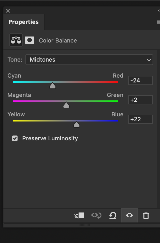

A colour balance Adjustment Layer increasing the blues usualy works:

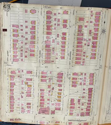

I didn't scan it . . . it was done by the Denver Public Library. They did a previous scan for me and also printed it and it was great. Unfortunately, they stop their printing services,
New Here ,
My photo of the page was much less yellow.

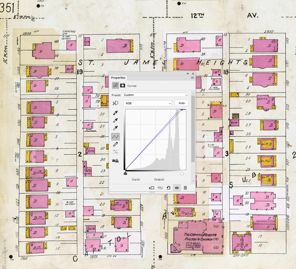

This was done with a Curves adjustment layer.
First, I dragged the highlight end point of the blue channel to the left to remove the yellow cast in the highlights.
Then I dragged the highlight end point of the composite channel (RGB) to the left to brighten the highlights.
I did the latter by dragging the white triangle below the histogram while holding down the Alt key (Option on a Mac) to prevent highlight clipping. The image will turn black when you do this, and clipping will show as colored areas.
After these edits the histogram looks like a comb, which indicates that image quality is reduced.
Jpg uses destructive compression to reduce the file size, and are not meant to be edited. Repeated edits and saves can seriously damage the image.
If you need to edit an image, and all you have is a jpg, save it as a tiff, and work on that.
For more information, see File formats.

Thanks.  The actual file really is a .tif (and 400 dpi, not the 300 of the sample). I guess the last thing I had saved was in .jpg format, and I didn't notice when this was being saved as a .jpg when I cropped and scaled it.
