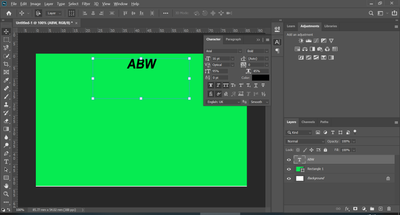

Could you please post screenshots with the pertinent Panels (Toolbar, Layers, Character, Options Bar, …) visible?
What is the font you used?

Thanks for your reply. I've kept this very simple but hopefully you can see - the font is Arial, the size is 16pt and it is in bold, with Smooth style. It is a text box on a background which is a rectangle filled in green. That's it.

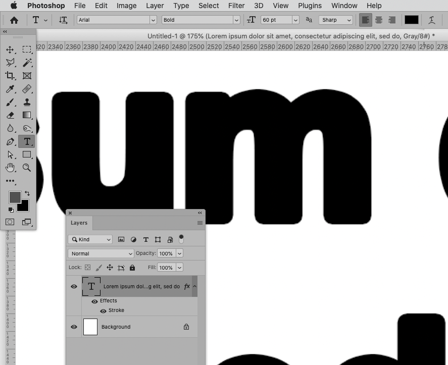

The corners may suffer with the LAyer Style Stroke, though, whereas a Stroke on a Shape Layer can maintain unrounded corners.

Unfortunately, the smallest stroke thickness is 1px. I had to triple my image size to get the font thickness to a good size.
Any good reason why fractions are not allowed here?
Dec 19, 2023 Dec 19, 2023
Yes, Photohop is pixel oriented image editing software.
And have you tried a Shape Layer Stroke instead of the Layer Style?
Edit: That Stroke allows for fractions as it is vector based, though vector output is only possible in certain file formats.

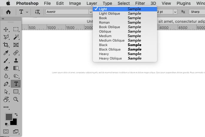

While using an outside Stroke definitely works, it is better practice to use a different font that is designed to look the way it does without modification.  When searching for a font to fit your needs, start typing Bo (bold) Bl (black) He (heavy) into the font field with Type tool selected.
You can do the same thing with other font atributes, like wide, narrow, light, italic, com (comic — Hey, I like comic fonts!).  You can combine those shortcuts. i.e. bo it (bold italic).
