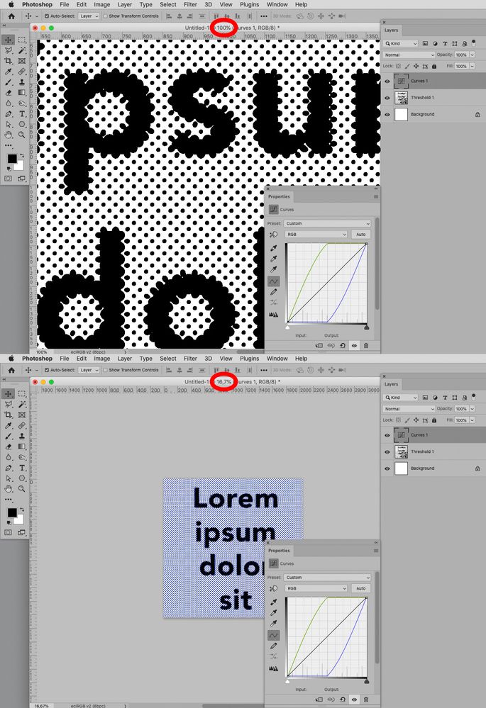

It's most likely a misleading preview because you're not viewing at 100%. In other words, the flattened version is the correct version. The preview was wrong.
100% is a significant number. It has nothing to do with size. It means that one image pixel is represented by exactly one screen pixel.
Is this a very noisy image, like a starry night sky? Or a "binary" image like line art or halftone dots? If you're zoomed out below 100%, what you see on screen is resampled and therefore softened. All
...Hi
The point is that at 100% zoom the preview you are seeing on screen is accurate and therefore will match the flattened image. If you zoom out, let's say to 50%, every pixel on screen represents more than one image pixel. In the case of 50% zoom, 1 screen pixel represents 4 image pixels. Now here is the issue, for previewing, that average of 4 pixels down to 1 pixel is done on each layer before blending the layers together. However, when flattening, each pixel is blended from individual layers

Hi
The point is that at 100% zoom the preview you are seeing on screen is accurate and therefore will match the flattened image. If you zoom out, let's say to 50%, every pixel on screen represents more than one image pixel. In the case of 50% zoom, 1 screen pixel represents 4 image pixels. Now here is the issue, for previewing, that average of 4 pixels down to 1 pixel is done on each layer before blending the layers together. However, when flattening, each pixel is blended from individual layers after which the 4 pixels are averaged to one screen pixel. That is why the two previews can look different. At 100% zoom there is one screen pixel for one image pixel so both preview and flattened image look the same.
There is also a further complication in that at zoom levels less than 66.7% 8 bits/channel are used even when the image is 16 bit.
All this is done for speed - can you imagine the delays in blending a zoomed out view of a 300,000 x 300,000 pixel image multi-layered image if every pixel had to be calculated individually for previewing?
So to "solve" it, always check your preview blending at 100%. As D.Fosse said earlier, it is the only fully accurate preview.

What was the Cache Level Preferences setting in CS6?
The Photoshop team has not fixed the bug related to Cache Level 1 for several years now so for the time being there seems no real solution.
You can select the top Layer and use cmd-alt-shift-E to create a merged Layer for previewing purposes and then delete it again.

The way to avoid this issue at lower magnifications was using Cache Level 1 and that has been impossible to use for years now.
By using lower resolution »stand-ins« to speed up previewing Photoshop can introduce pixels of values that do not acually exist (or change the relative quantities) and Adjustment Layers, for example, can have an effect on those »preview-pixels« that the full resolution content simply does not provide.
An easy example being pure a black and white RGB-image with a Curves Layer.

@KBlab Check your preview at 100% zoom. That shows the real blend, I.e. every pixel blended individually, and should be identical to the flattened version

100% is a very significant number. 100% means that one image pixel is mapped to exactly one physical screen pixel. It also means that all adjustment and blending previews are calculated on the full image data, pixel for pixel.
Just try it. Open one of these images and press ctrl+1 to view at 100%. Then flatten.

I did not see this at 100%
By @kkrip
That's the giveaway.
Whenever something seems to change when merging layers, it's because you are not viewing at 100%. The merged result is correct. The preview is misleading and incorrect.
100% has nothing to do with size. It means one image pixel is represented by exactly one physical screen pixel.
For performance reasons, all blending and adjustment previews are calculated on the on-screen sample of the image. When you are zoomed out, that means a resampled and softened version of the image. Pixel levels are averaged out. You get a lot of intermediate values that aren't there in the full original data.
When you merge, commit an adjustment etc, the numbers are re-calculated on the full original data, pixel for pixel.
Viewing at 100% is the only way to avoid this, and get an accurate preview of the final result.
