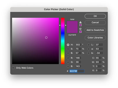

Mar 23, 2023 Mar 23, 2023
I am overly simplifying here but basically if you want to make your image more vivbrant you need to increase the saturation, so your purple is maybe not saturated enough.
see my screenshot
Also you're using a screen blending mode, by definition it washes out the colours (it only applies to the lighter parts of the layer below and multiplies this effect by the own lighter parts of that layer, so double washed out)
see an explanation on blending modes:
https://helpx.adobe.com/uk/photoshop/using/blending-modes.html
So my best bet to make it more saturated would be to use another blending mode (try Hue and scroll from there, as the effect depends both on the top layer and the one below)
