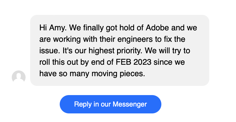

@David Cardillo, PRH @Stephen Marsh @Kevin Stohlmeyer @schroef @Bob_Hallam  Pantone says the Connect will hopefully be working with channels by the end of FebruaryScreen Shot 2023-02-03 at 6.52.00 AM.png..
Still hostage, but at least the workflow will hopefully be fixed even as other alternatives surface.

ok, but at $5-8/head/month for around 200+ users, where everyone has to have their own unique login?
I'm guessing it's just a coincidence that the V4 books have become unstable in PS 2023
Feb 03, 2023 Feb 03, 2023
The current pricing according to pantone is $180/user/year PLUS $3000 for the licensing manager - which is expected at the end of February. The hold up is it is not working with Single Sign On.
