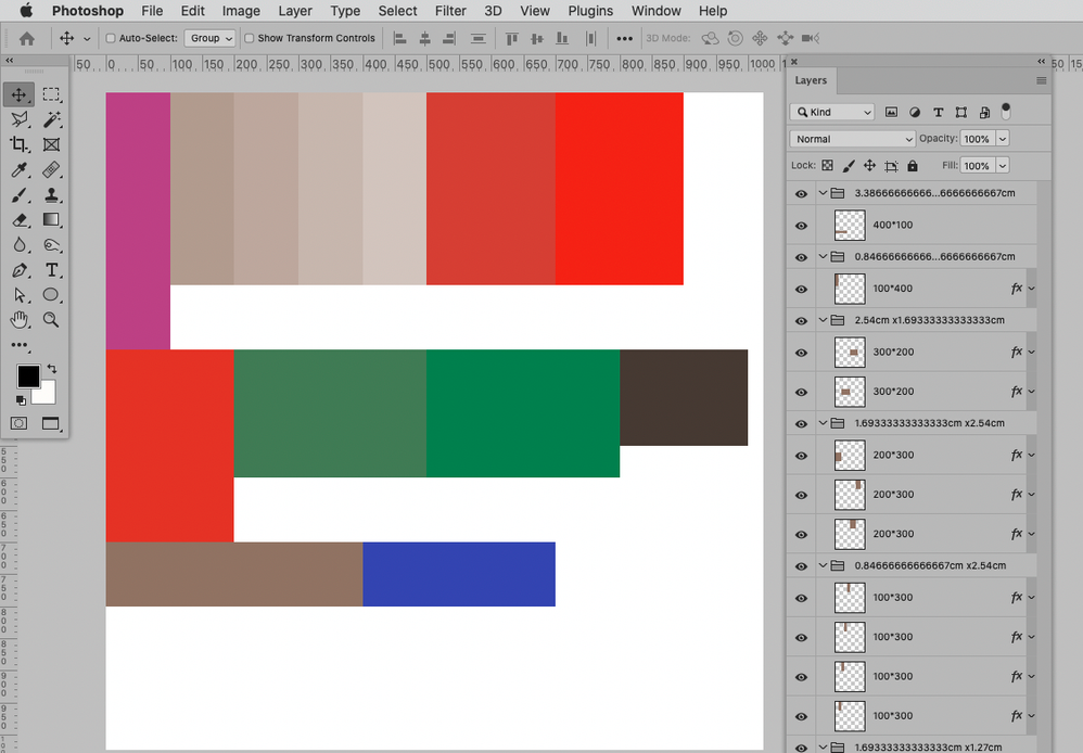

Try replacing the line
groupSelectedLayers (theArray[m][0][3])
with these three lines
        var theW = theArray[m][0][3].split("*")[0]/activeDocument.resolution*2.54;
        var theH = theArray[m][0][3].split("*")[1]/activeDocument.resolution*2.54;
        groupSelectedLayers (theW+"cm x"+theH+"cm")

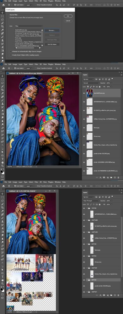

I have a simple request
If I didn't bother you
When arranging layers and placing them inside the group
There are layers sticking out from the design
Is it possible to arrange layers within the design
Nov 24, 2021 Nov 24, 2021
One could process the groups further, but getting at a truly efficient usage of canvas space would seem quite difficult to me
Yes that is the boat I'm in.  Its a puzzle beyond my math and logic skills. And the code you posted as you stated would not work where there were a lot of image the same size for laying them out horizontally will exceed the canvas width. But the it no difficult to add canvas. The op does not appreciate how difficult the the puzzle is.
I punk out I size the image to a single brick size and bricked the canvas  without staging the bricks.  I retired I have the right to take the easy way out.
JJMack

JJMack
Enthusiast ,
I am very grateful for your effort and interest
But the c.pfaffenbichler code sorts the images from this
to this
In No. 1 the required was done as I wanted
And in number 2, I liked the arrangement of the side pictures of each other
But in the event that the number of pictures is many
I found that the pictures are out of the way of design
I want a code that arranges images in the same way within the design boundaries and not outside the design
From the beginning I have written to do a optimal layer layout is a very complex and a challenge far beyond my skill level.  I only hack at Photoshop Scripting I do not know Javascript. Adobe Scripting DOM does not cover all of Photoshop features,. So Action Manager Code must be use to script many  of  Photoshop features. While I can use code the Adobe Scriptlistener plug-in logs in Action Manager code it is not very readable and only covers half of the story the execution half of the action manager capability. The retrieval capability half of the action manager get is not logged by the Scriplisener.   When you do not know what event the Action manager has and their four Character ID and the data structures required for action manager code. Much of what you can done scripting Photoshop  is out of your reach.  As far as I can tell you do not understand what is required to solve the optimal layout solution. I do not believe you even tried to write any Photoshop script code to see what you can do to to solve your issue.  All I read is I have a simple request I want this I want that. Your request is far from simple,  You need to work out the solution so far no no one here has a solution for what you want.   What you want is  feasible and may even be available in some Application design for layout problems. Photoshop is a Pixel editor.
JJMack

Nov 25, 2021 Nov 25, 2021
Below will still not provide optimal results, but avoid some issues.
Maybe it is time for you to explain what you are actually trying to achieve – what is the real task you are trying to automate here?
// distribute layers on canvas;
// 2021, use it at your own risk;
if (app.documents.length > 0) {
	var savedRuler = app.preferences.rulerUnits;
	app.preferences.rulerUnits = Units.PIXELS;
	var myDocument = activeDocument;
	var docW = myDocument.width;
	var docH = myDocument.height;
	var theLayers = collectLayersBounds ();
// sort by height;
	theLayers.sort(sortArrayByIndexedItem);
	var theRefX = 0;
	var theRefY = 0;
	var lineH = 0;
	for (var m =0; m < theLayers.length; m++) {
		var theX = theLayers[m][3];
		var theY = theLayers[m][4];
		var theW = theLayers[m][5];
		var theH = theLayers[m][6];
// check if line exceeds doc width;
		if (theRefX + theW >= docW) {
			theRefX = 0;
			theRefY = theRefY + lineH;
			lineH = 0;
		if (theH > lineH) {lineH = theH};
// move group;
		moveLayer (theLayers[m][2], theRefX-theX, theRefY-theY);
		theRefX = theRefX+theW;
	app.preferences.rulerUnits = savedRuler;
