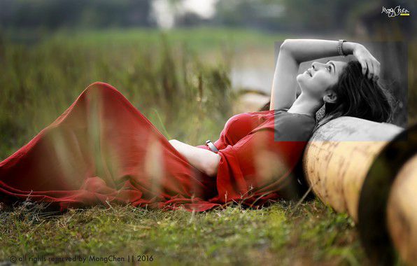

Thank you for asking for clarification.  Here is what I would like a script to do:
Step 1:  Open Photoshop.
Step 2:  Load the first pair of images into a stack, so that the original image is on the bottom layer, and the processed image is on the top layer.  This can be done with the stack images script or place embed command.  But it seems to save steps with the stack image script.  Once stacked they should look like this:
Step 3:  Select both layers, choose Auto-Align Layers (no blending), using the "auto" setting.
Step 4:  Export with the same file name to .tiff with these settings:
So that the final output image looks like this:
5.  Repeat until all matched pairs are auto aligned.
Would be awesome of the script could work on both Mojave and Windows 10, but if I have to choose, Windows 10.
Here are links to Google Drive, of the originals, processed image, and output from photoshop:
Original Images:
Processed Images:
The output of the three sets of matched pairs (original and processed) should look like when auto-aligned:
No need to blend, crop, resize, or anything, simply auto-align the the pairs, and export.

Apr 23, 2021 Apr 23, 2021
You you should be able to stack two images using photoshop scripting with the small smaller image on top. Target both layers , use Photoshop menu  Edit>Auto Align Layers to do your alignment,  save a jpeg composite and close the document. Repete for the next two images.
Auto Align Layers worked with you sample image when I did the steps Manually.  Though Edit>Auto Align Layers opened a dialog window that I had to click on its OK button.  When I recorder that step in  an Action the layers just aligned there was no dialog that opened it would work in a script without showing a dialog.
