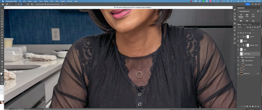

We would need to see the entire workspace with the layers panel open. Cmd-Shift-3 will produce a Fullscreen snapshot file on the Mac Desktop which you can then upload in a reply.
New Here ,
Aug 24, 2024 Aug 24, 2024
Here you go...
The Layer you are on is invisible because you unclicked the eyeball next to it, and that is why you see the prohibited symbol. You can choose a visible layer and if need be, checkmark "sample all layers" in the top options bar. I guess you have that layer turned off for a reason.
