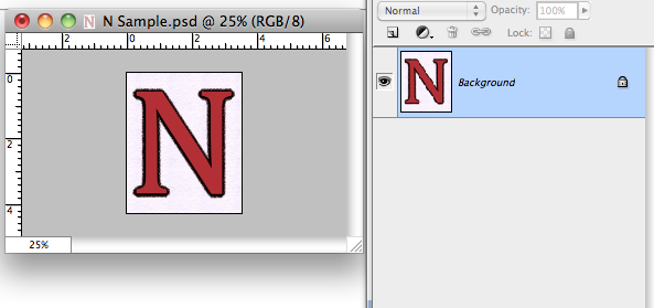

Here are some screenshots demonstrating what happened.
This is the file before flattening:
After flattening:
And without "dissolve" on Layer 21:
May 14, 2011 May 14, 2011
Especially for things noise effects like dissolve, you have to zoom in to 100% to get an accurate preview.
You were zoomed out at 25% -- seeing a downsampled preview (subsampled for the dissolve blend) before flattening, then seeing a downsampled (slightly blurred) preview after.
Unfortunately, noisy effects like dissolve are impossible to preview accurately at downsampled sizes.

Christian - I followed only steps 3-5 in post #56.  I'm not getting the resulting image, which when loaded in photoshop with a transparent background layer saves beautifully. I've selected the GroupMerge SubGroup with the magic wand tool with the settings described in post #56 then proceeding File > SaveAs > PNG and the result saves with a black background.
As for CopyMerged it works but the blackbackground is saved along with it, I don't want no blackbackground I want to save the file as a transparent PNG. I realize it's not difficult, but why am I not getting the results as displayed in the image below ?
http://forums.adobe.com/servlet/JiveServlet/showImage/2-3683662-69015/SubGroupMerge+remove+black.png
