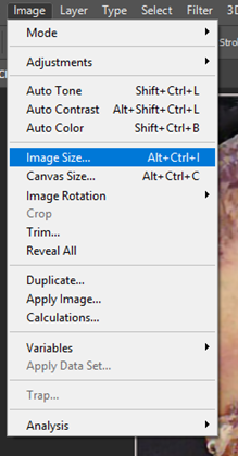

Ø I THEN PERFORMED IMAGE> IMAGE SIZE>
AT THE IMAGE SIZE MENU I DID THE FOLLOWING
4000 PIXELS WIDTH>RESAMPLE: PRESERVE DETAILS 2.0>MAGNIFY IMAGE TO 100% >>REDUCE NOISE TO 88%>OK
THIS RESULTED IN AN IMAGE THAT BECAME 13.333INCHES X 16.11 INCHES (300PPi) ACCORDING TO THE DOCUMENT DIMENSIONS INFORMATION
I thought that by increasing the pixels in the original image would yield a higher resolution of the image, thus providing a technically more efficient photo to work with. Am I misunderstanding the whole premise of EDIT>PREFERENCES>TECHNOLOGIES PREVIEWS > as well as the function of  image size improvements?

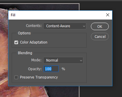

When using the lasso tool this is what occurred:
I drag a selection around the face
The marching ants appear. I press shift-backspace to fill in
The process for filling in occurs
But the area remains unfilled, with the marching ants still active.
I press select/deselect and the damaged image remains intact

Okay.. so let me address a few things one at a time.
1. you cannot simply take a 300px x 600px image and upscale it to 4000px x 4833 and expect that the results will look like anything usable at all. You are enlarging by more than 1000 percent of the original size. there is just not enough information in that small partial image to resize it as much as you are expecting.
2. Regarding your content aware fill not showing up, I can only guess that you are on the wrong layer. We would need to see a full screenshot of your workspace to identify anything more than a guess.

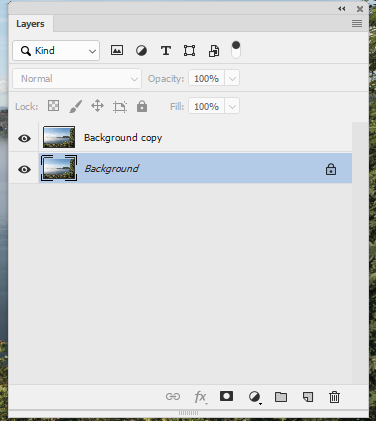

Feb 26, 2019 Feb 26, 2019
Have you by any chance duplicated the layer and have the lower layer selected in the layers panel?
That would give the effects you describe, with the changes (clone/heal fill) happening on the lower layer whilst hidden behind the upper layer
