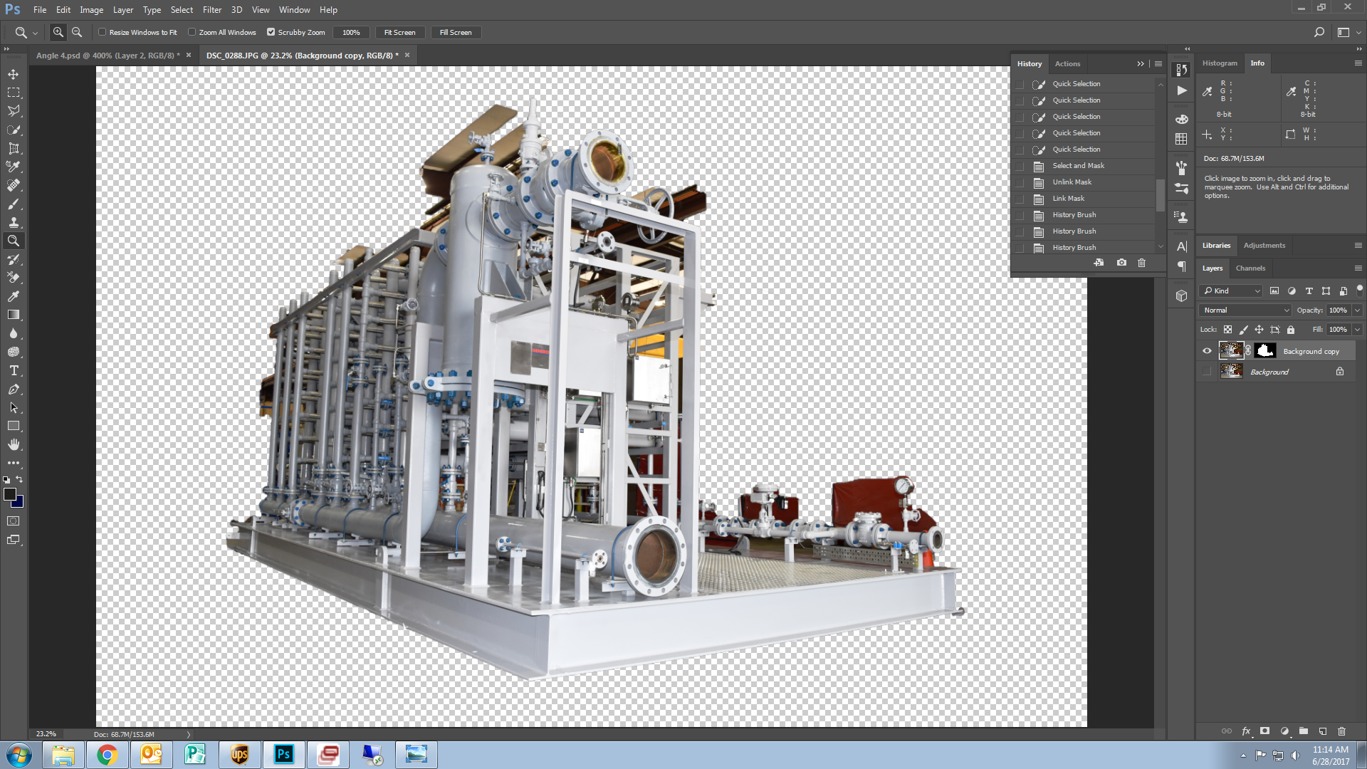

So I did this.
Smart select
The Layer > Layer and mask
Then I added a black layer behind it all since layer and mask left me with a transparent background.
But were back to my original problem, that the history brush isn't working?

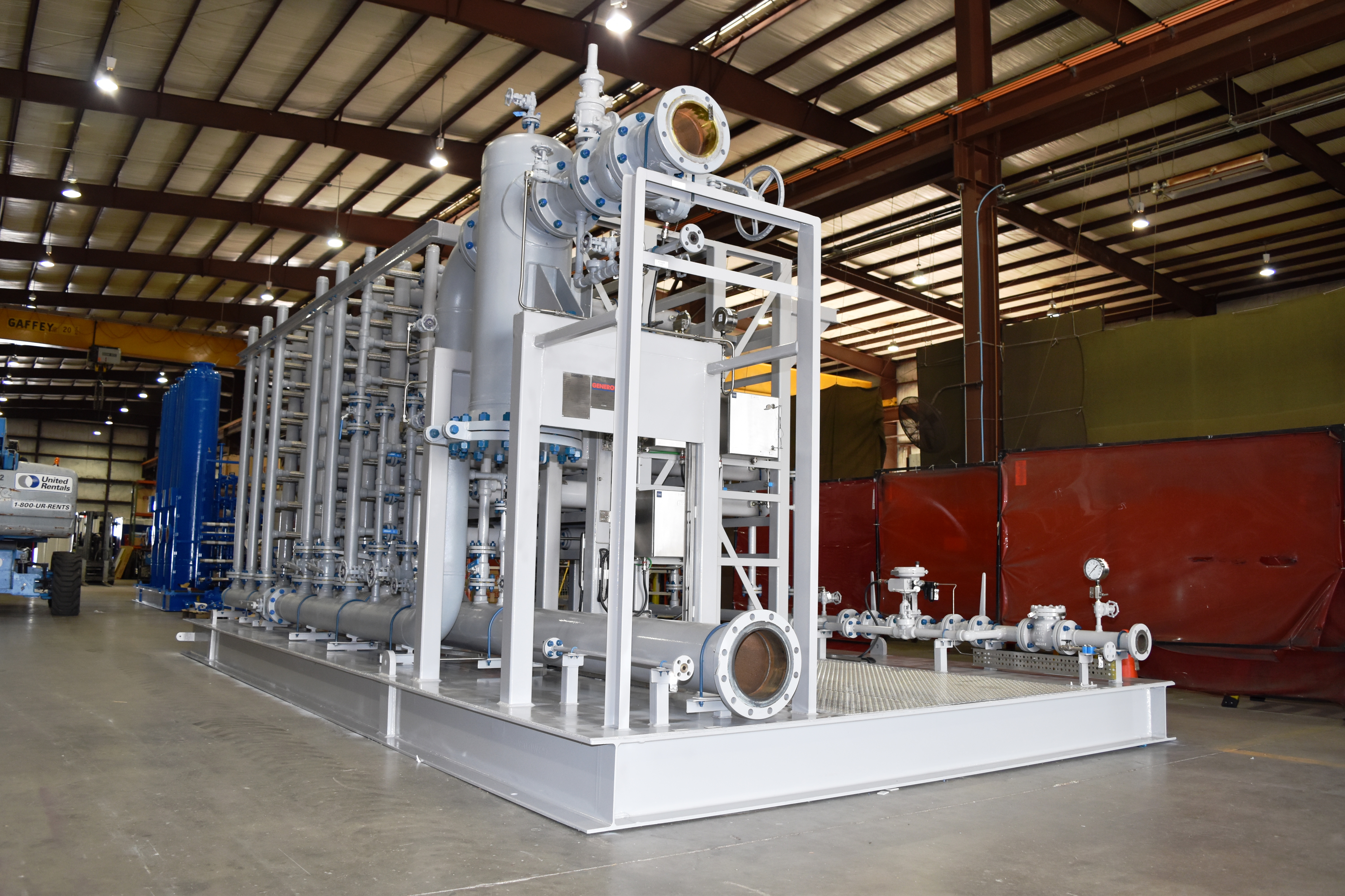

This is the type of beast I'm editing.  See all the nooks and crannies?
The background is inside the shop, so I cut the majority out, then have to go in and revise.
Which is where i find little pieces missing, not carried over by the smart select.
But by the time I find what wasn't included, or see that it cut a little too much off of the edge of something that now looks weird, I'm an hour of detailed background removal into this thing and I can't just go back to the orginal and remask it.
If it were a simple image like what you used, layer and mask might would work, but it seems my answer is just to not use any layers.  If I stay in one layer and one layer only, the history brush should always work?

Okay... I'm not sure I understand completely... but here is the image.
Jun 28, 2017 Jun 28, 2017
Hi
To do a mask of that machine the best is the pen tool :
Draw with Pen tools in Photoshop
Set the pen tool to path and the path to combine shapes
Draw around the outside of the machine so you have a path outlining the whole machine
Draw a point on an inside shape that you will exclude from your selection and set the pen tool to subtract front shape.
Continue to draw round the inner shapes until you have a path outlining your selection and with the bits you don't want - excluded

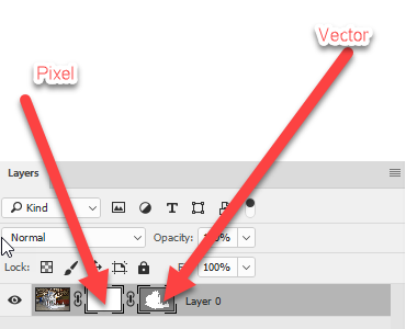

So now you have a path - you can convert it to a mask :
With your layer selected in the layers panel and the path selected in the paths panel go to the bottom of the paths panel and click twice on the mask icon
This will add an empty pixel mask and a vector mask to your layer in the shape of the path you just made.
You can adjust the mask by clicking on the vector mask and re-adjusting the path points on the image with the direct selection (white arrow) tool.
You can also paint on the pixel mask in black /white to fine tune or feather where you want any semi-transparent areas (not really needed in yours)
The result with a gradient layer behind it:
No pixels have been removed - therefore the mask is fully adjustable later
Dave
