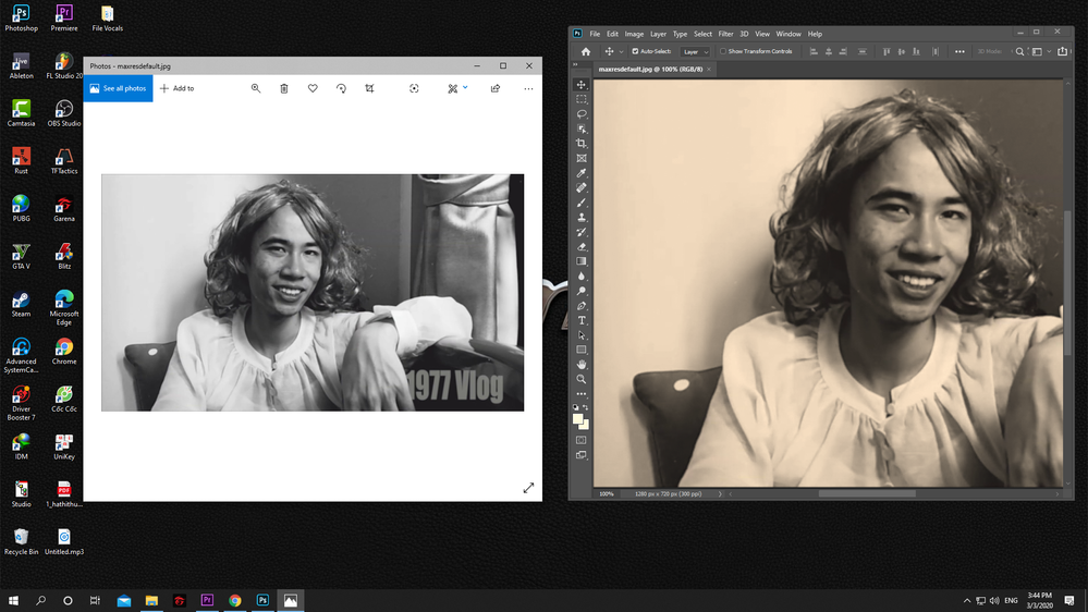

New Here ,
Mar 03, 2020 Mar 03, 2020
111.PNGok
