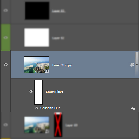

Convert the layer to a smart object.
Then apply blur to it. Now you can adjust / remove the applied blur @ what ever point of time unless you merge the layer.
