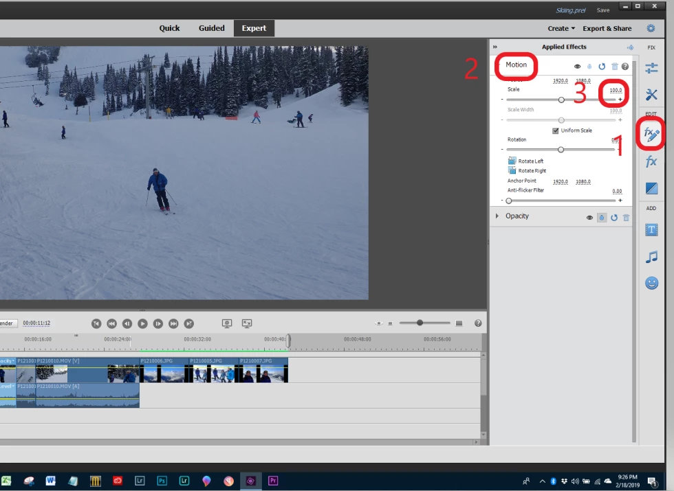

3) Is there a way to get a video to "snap back" to it's original size in the frame after you and "resized" the video (stretched or shrunk) in the viewing frame?

Correct answer Bill Sprague
To get it back to fill the monitor....
1.  Select Applied Effects
2.  Select Motion
3.  Type in 100%

Bill SpragueCorrect answer
February 19, 2019
2.  Select Motion
3.  Type in 100%

In this image I have "zoomed in" on a clip. Now image I have made some changes elsewhere in the video. I have come back to this clip and decided I want to back to it's original size. I can drag the corners back in, but am always afraid I might leave a portion of the picture not in the frame. It would be nice to hit a key stroke and have the clip "reframed" in the viewer in it's original size.
So, now how to get it back, drag the corners is not as exact as a key stroke to restore it without using "go back"
