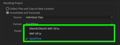

Thanks, @Odobe , that's a good start.
However, it doesn't fully solve the issue. When using the “Render and Replace” method, Premiere creates files with handles but also copies the original clips into the archive. This happens because "Render and Replace" links the transcoded clips to the original clips somehow. If you try to delete the original clips before creating the archive, Premiere Pro won't create the archive due to the missing original clips. What a mess.
One of the best way to make Project manager works flawlessly in Premiere Pro is to set the projet to transcode all clips in .MOV when importing them in Premiere Pro :

@danielrucciOh, I know, but keep in mind that the cumbersome workaround is only necessary if you're working with video formats not supported by Project Manager.
If you work in Premiere with one of the three formats listed in Project Manager, you'll have no issues. You can even create custom presets with Media Encoder and transcode very light archives! 🙂

The project manager has never been able to trim Long GOP media (H.264/HEVC) camera originals. Transcoding to an editing codec instead of editing with the raw files helps the project manager's workflow and provides a smoother editing experience. Once you edit with a proper codec, the project manager will work as expected.
Editors making this slight change in workflow (transcode to ProRes LT on import) would be super happy with the results during the edit, exporting the edit (using smart rendering) much faster and being able to easily archive a project using Project Manager. Transcode on ingest happens in the background, so you don't have to wait for copies to complete before editing.
