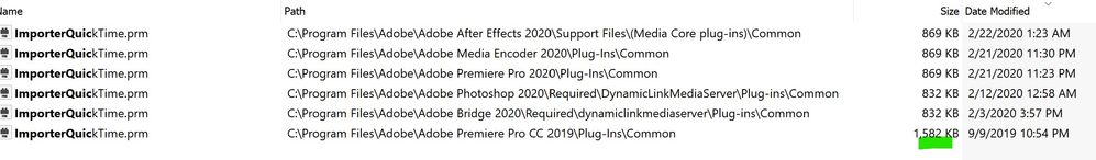

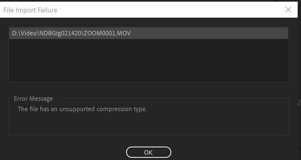

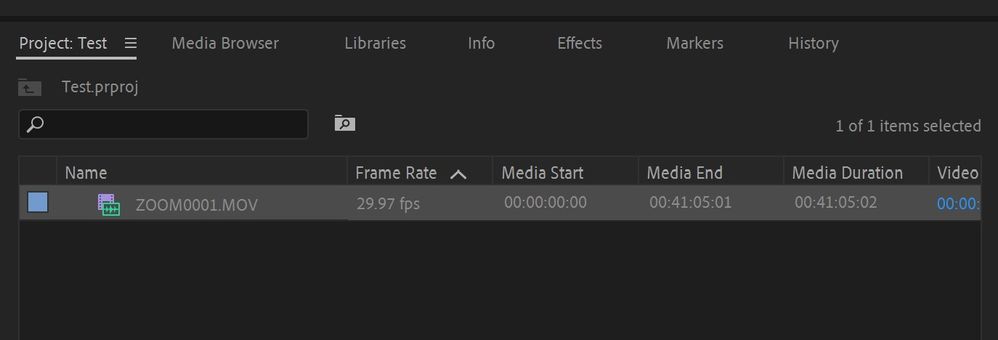

Follow up - Just tried 14.0.3 version and, like 14.0.2 before it I get the same error.  I noted that what I think is the importer for .mov files did change (a lot from 2019) and perhaps that's related?
Error message with file that works in 14.0.1Error message with file that works in 14.0.1Noted much smaller .mov importer than beforeNoted much smaller .mov importer than beforeSame file in version 14.0.1Same file in version 14.0.1

The .mov files that do not work in any Premiere Pro 2020 version after 14.0.1 work just fine in 14.0.1.  I keep installing an update, testing it, removing it and reinstalling 14.0.1 and it works.  I just did this again with the exact file I shared with you and again:
PremierePro 2019 - latest version - file imports correctly
PremierePro 2020 14.0.1 - file imports correctly
PremierePro 2020 14.0.4 - file will not import: "The file has an unsupported compression type"

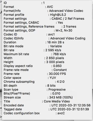

exported .mov from Camtasia 3 for Mac is also unsupported unlike in 14.01
Media info
Hope you guys find a fix for this in 14.0.2

LEGEND ,
Apr 02, 2020 Apr 02, 2020
Sharkster,
Interesting ... I do a lot of Camtasia on my Win10 machine, latest Camtasia version, to 24fps ... and it comes in perfectly. Wonder what the difference is?
Neil
Community Beginner ,
I'm wondering too.
The import process from Camtasia .mov to Premiere 14.01 on a Mac was seamless until now.

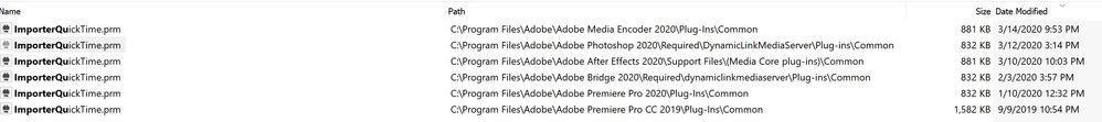

Just noted and installed another Premiere Pro update though, this one still said 14.0.4.   Again, no change.  The 2019 Premier Pro opens the same file flawlessly.    I believe it's the ImporterQuicktime.prm file.  Note the file size of the two versions.  It's rarely been my experience that improved software gets smaller in size. QuickTimeImporterBad.jpg

Just installed Premiere Pro 14.1.  No change. There was no changes to the ImporterQuicktime.prm so I'm not surprised.

Is there a way to flag this as "unsolved" I never marked it as "complete" despite what it says above.   As you can see I try with each new version and in each of now four updates since this problem was posted the result is the same.  A .mov file, made with a Zoom Q8 that opens fine on either Premiere Pro 14.0.1 or on Media Encoder 14.0 will not open in any update to either application since.    As Premiere Pro 13 seems to open the files fine as well I suspect the problem is ImporterQuicktime.prm which was double the size for Premiere Pro 13 and early versions of Premiere Pro 2020 than that file is now.   The new updates will open a .mov from an iPhone so I suspect testing stopped there.   I'm going to be very unhappy if my renewal of my Creative Cloud subscription payment is taken and the old versions I can still use go away.   I'm happy to work with anyone (and as you can see below) have sent the information to Adobe people already.   This is NOT solved.   Thank you.
